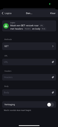

Edit: I guess I understood your question wrong. You can easily make GET requests using this Logic card:
in this case, with a simple logic card.
