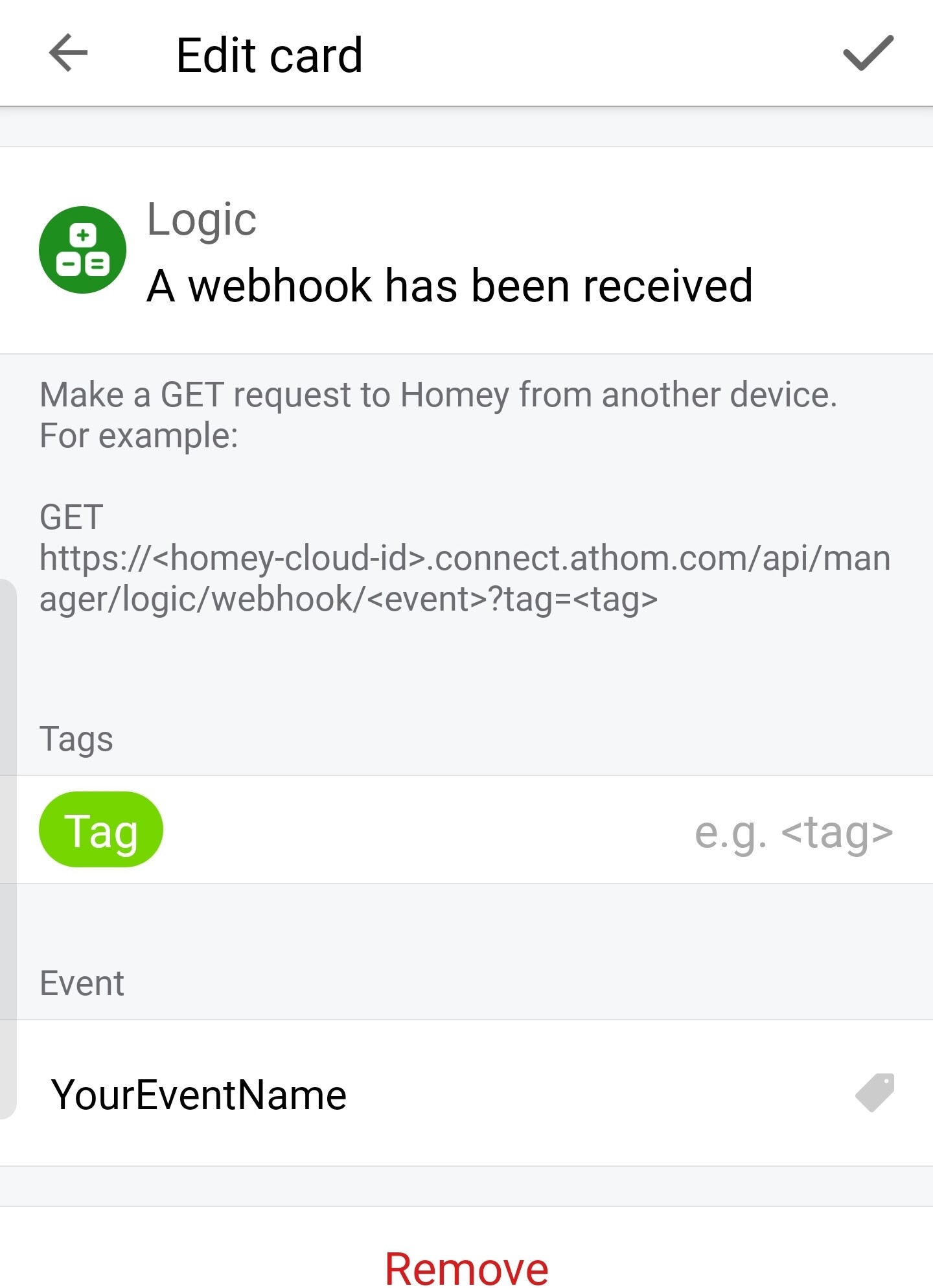

From anything in your local network you can send a webhook to Homey:
http://homey.ip.address/api/manager/logic/webhook/YourEventName?tag=YourTag
The ‘tag’ part is optional.
Homey responds to the example by using this Logic trigger card
like this:
