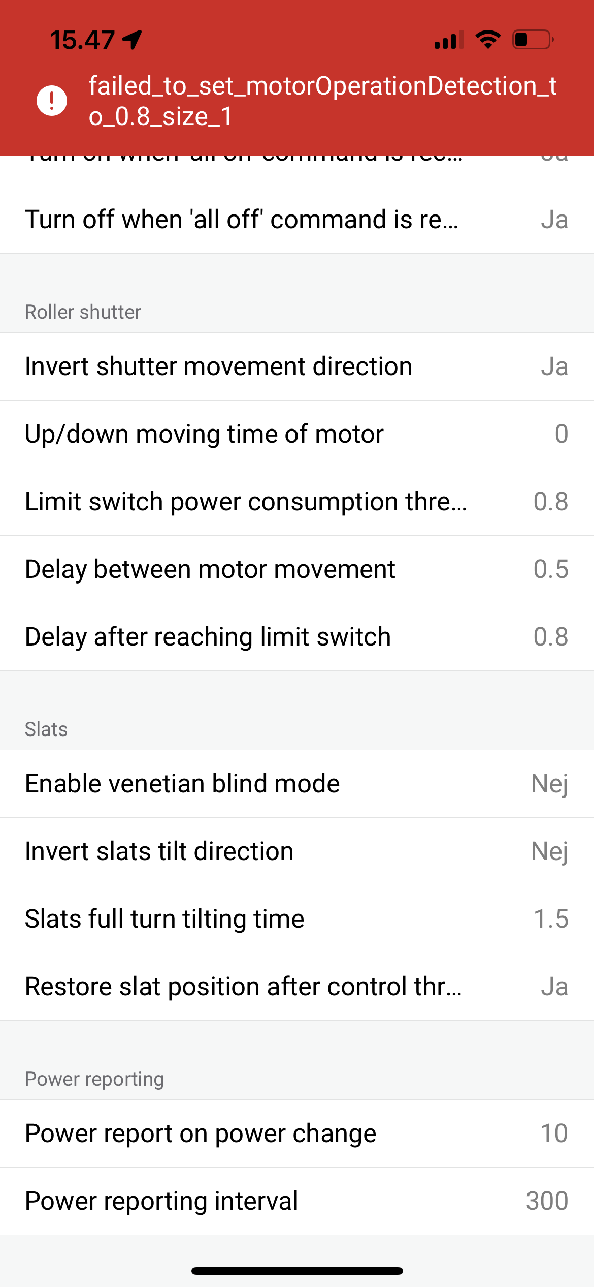

The calibration option returns an error saying that it could not start the maintenance.
The limit power switch consumption: When I try a change / increase it, it returns an error “Failed_to_set_motorOperationDetection_t_o_0.8_size_1” And this error is returned on any value I try. it will only accept 0.6 (the standard value)
