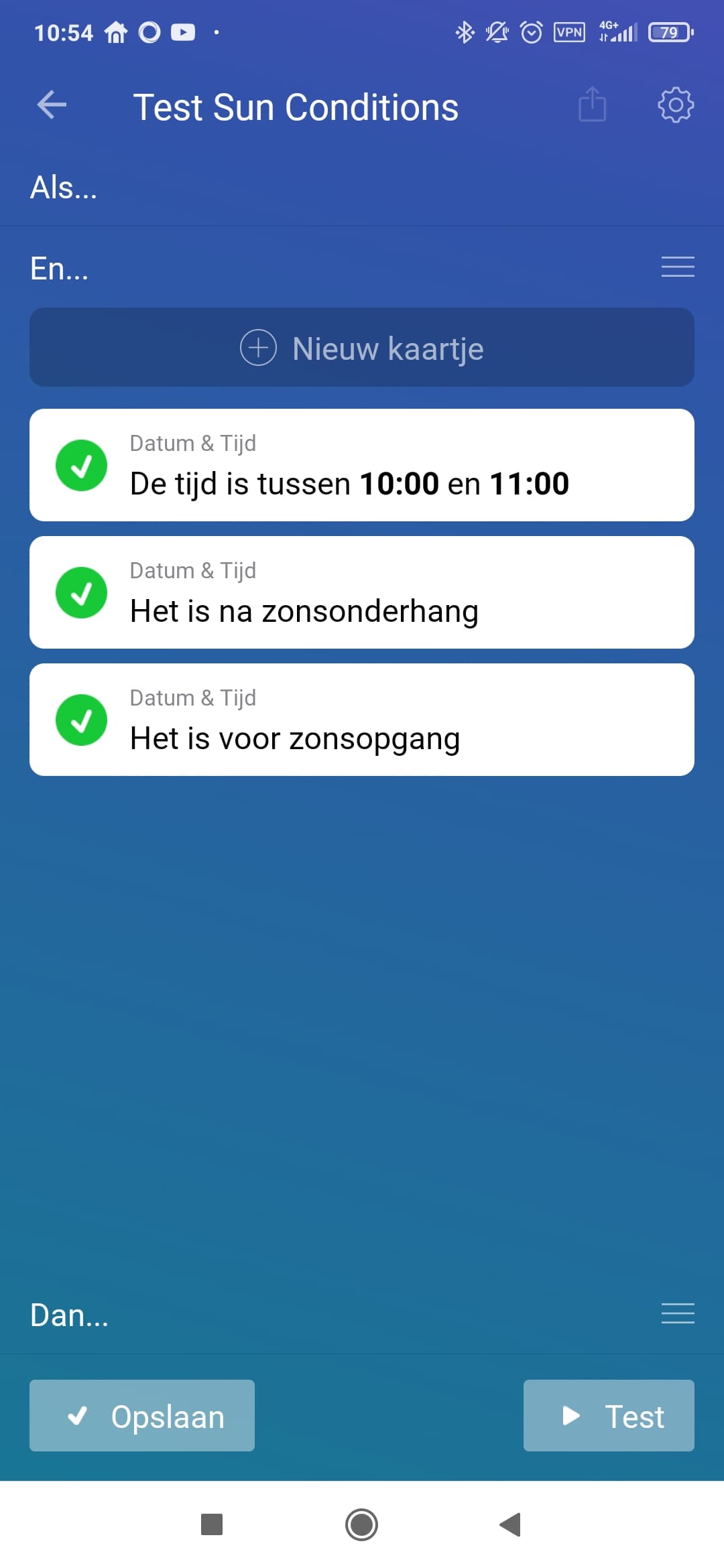

EDIT: made an example for you, ran this test a few minutes ago:
The conditions are marked as valid after testing now, but I am quite sure it is before sunset and after sunrise…

Did u fotoshop this @Sapperdeflap ?
chrome_0k6f9VCLXu
No photoshop, this is how it works on my app, location is set to a Dutch city, so time should be GMT+1

Ok. Was wondering about the “zonsonderhang”. Bug or fotoshop?
Confirmed (door @Dijker) bug in de Cloud versie.
