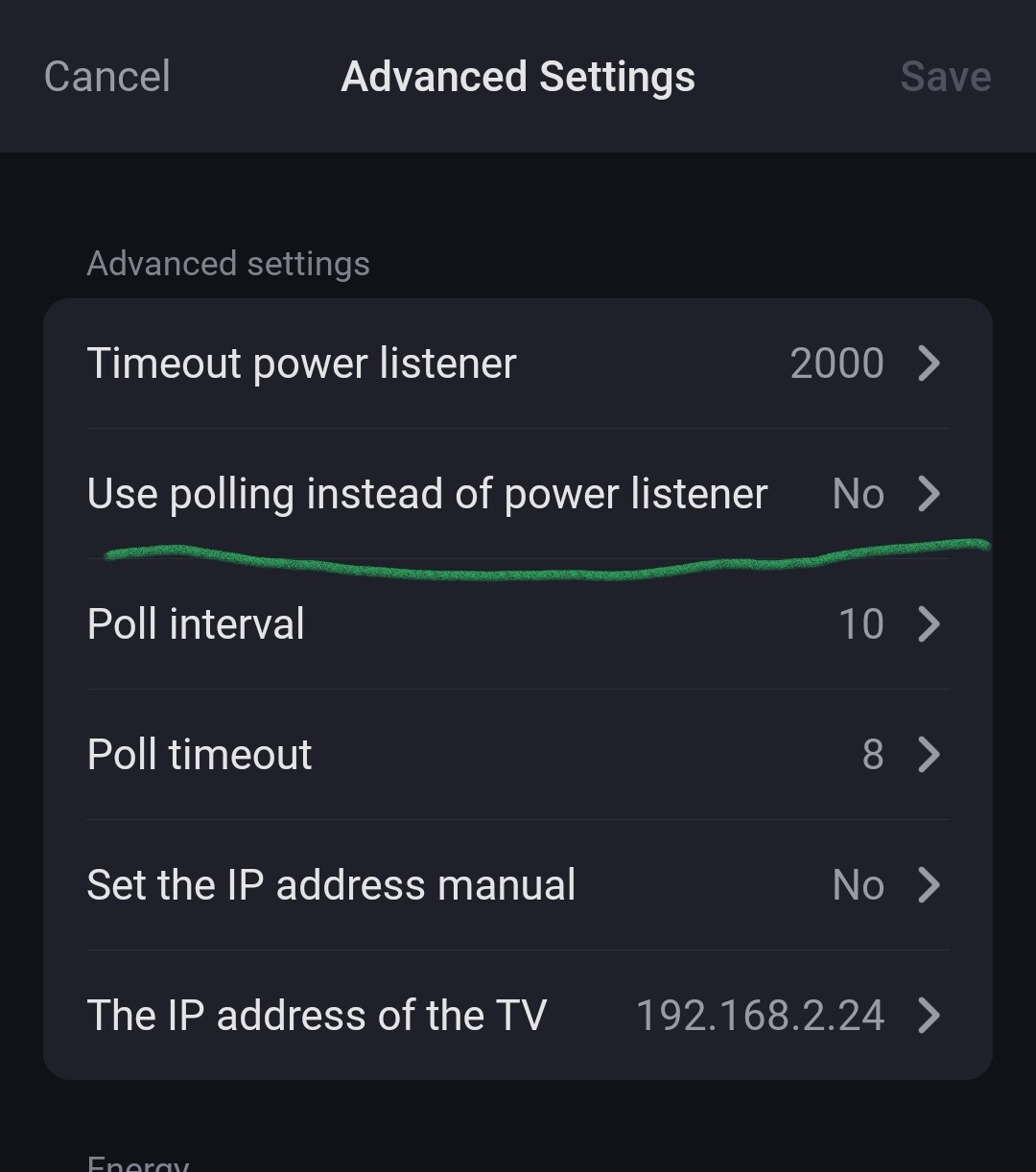

The WebOS plus app has 2 different ways for tv detection;
you’ll find it in device settings, advanced.
I’d like to suggest to try to change yes to no, or no to yes, to see if it works better.
You can increase “Timeout power listener” if “Use polling instead of power listener” is set to No.
Maybe entering the IP address for the TV might help as well.

Hi Peter,
The issue is that the WebOS Plus app itself doesn’t have those advanced settings.
The settings you’re showing are for a WebOS Plus device, but I can’t add the device in the first place, so I don’t have access to the advanced settings you’re referring to.
