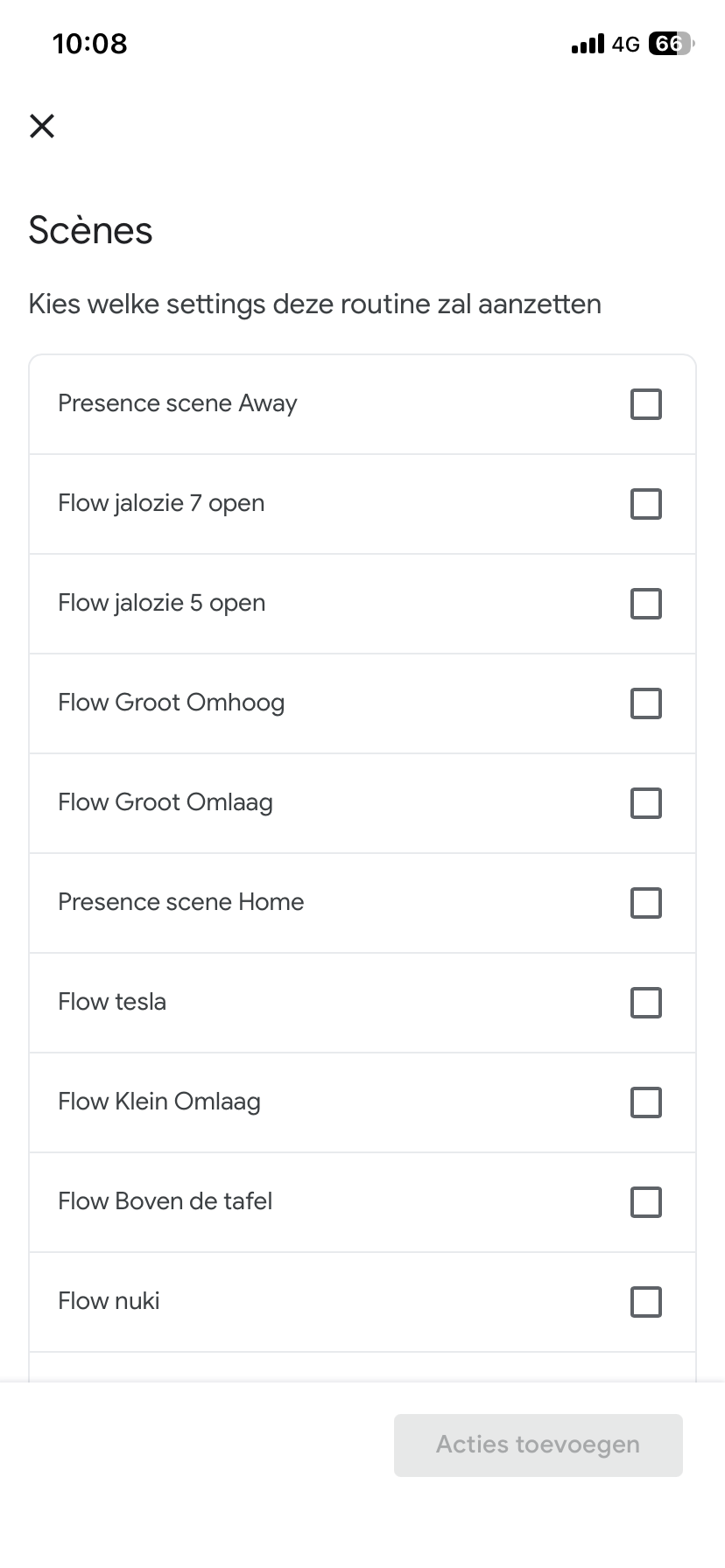

You can start favorite flows in Homey 2023 Pro using Google Home, but only I can do it — other people in my house can’t. What am I doing wrong?And I don’t want to use virtual devices because it gets too messy.Who can help me?

No, I mean this — see the photo. For me, this does show up, but for the other Homey users it doesn’t. I must be doing something wrong. Do I need to share my home in Google Home, or does everyone need to create their own home in Google Home? I don’t know.

As far as I know you’ll have to share your Google Home with the other Homey users first.
