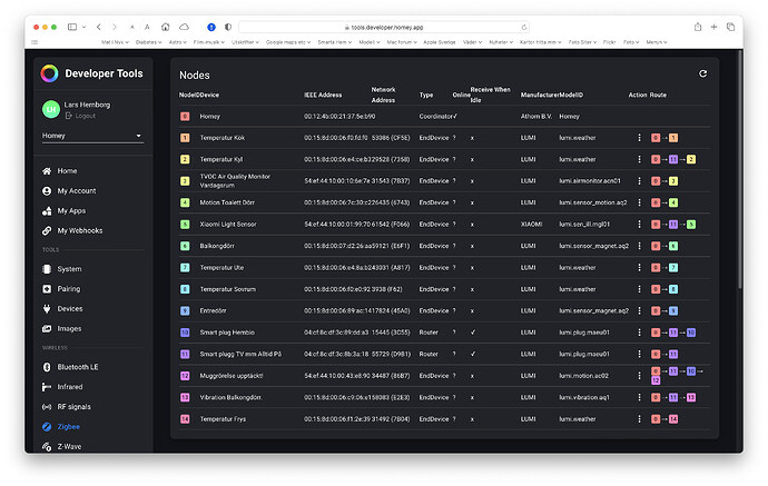

Well, I’m brand new at this but looking at the bulbs in Developer Tools it looks like they are on the Hue hub, but the smart plugs are not as they are routers…
Question is, how do I connect EndDevices to those routers?
Bulb:
Down almost at the end, Smart Plugs (Routers)
It should happen automatically and I think it has for the penultimate two for example
Some off your devices are already routing over the ‘router’ devices. But best practice is to first connect router devices to your Homey and after that connect end devices.
Since your router devices are number 10 and 11 I suggest you to reset Zigbee, add your router devices first (if possible add more than 2 i.e. maybe you can move a Hue lamp to homey) and then add the end devices. Add the devices in the place of intended use and start with the devices closest to homey and work outwards.
Also, don’t add them to fast after each other, let them settle a bit before adding the next device.

Be also aware that the bulb you mentioned is a router-device, but is not in the Homey-zigbee-network, but in the Hue-zigbee-network. If you add it directly to the homey, as one of the first devices, it will act as a router in the Homey-zigbee-network.
Also, how are the routers (2 is not much) spread around your house? If they are further away than some end-devices, it’s most likely that these end-devices will not use the routers, but connect directly to the Homey.

How do one know if end-devices are indeed connected to a smartplugg?
tools.developer.homey.app under “Zigbee” you will see the last known route of the devices.
In this image it looks that some end-devices are going via a Smart Plugg, is that right?
Look below :slight_smile:
Yes, that is correct. But i can not help to notice, that you have included your routers pretty late. You should exclude the end devices that is listet before the routers, and include the excluded end devices once more.
Well, lights and pluggs added them self kind of from Philips Hue, then I added the end-devices, mostly Aqara… well it works now anyway.
Your Hue devices are in a completely separate Zigbee network and don’t do anything to improve your Homey Zigbee network.

There are no lights in the Homey-zigbee-network, and three non-Philips-Hue-plugs, in your homey-zigbee-network (nrs. 10, 11 and 15). All the other devices in this network are different kinds of sensors (end-devices).
