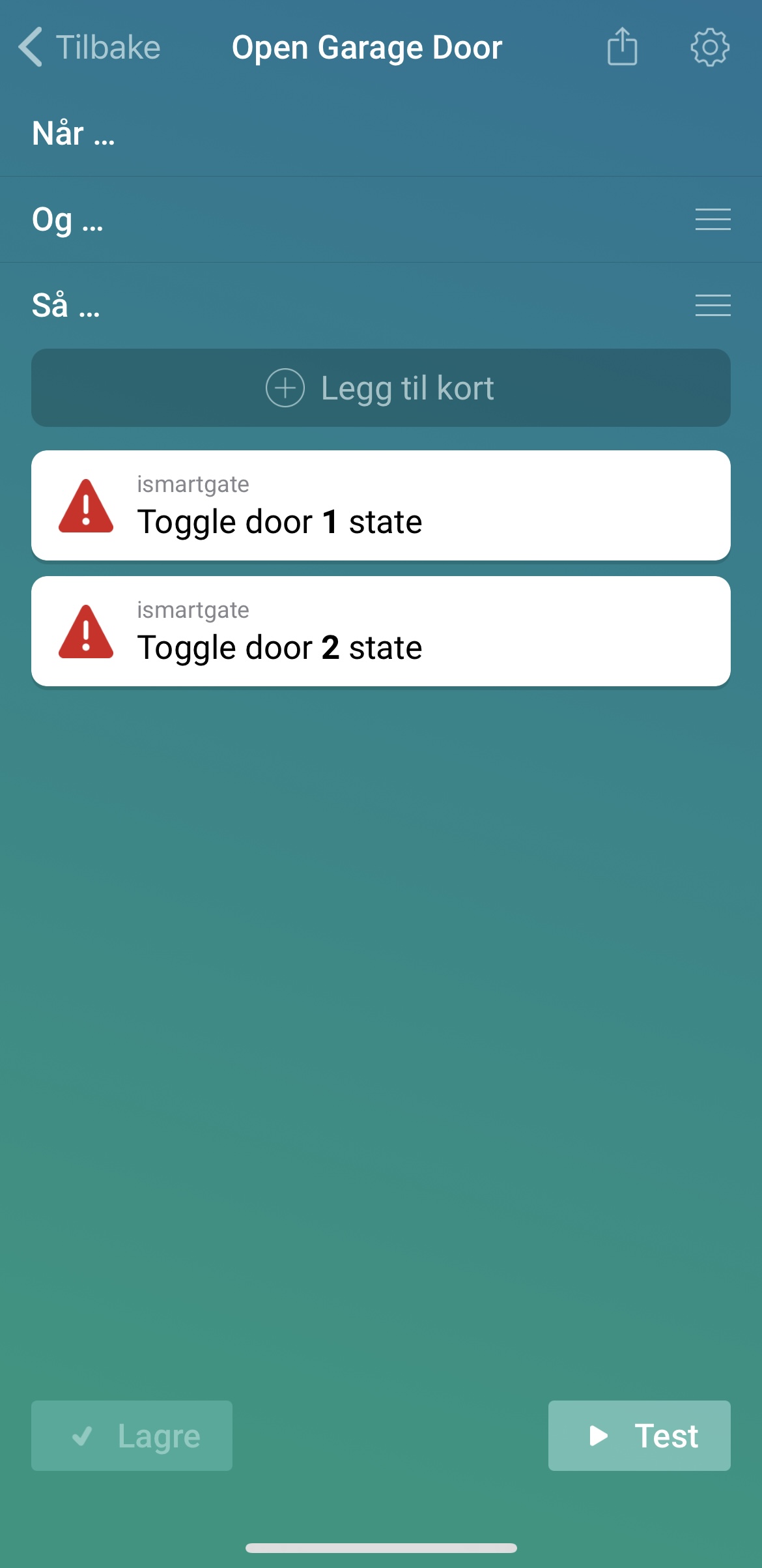

I get that I cant add the gates as devices, but when adding the ismartgate app at “then” in a flow: It doesn’t work. This screenshot shows the alert (!) I get after testing the flow. I uninstalled the app. Rebootet the Homey, reinstalled, readded the ismartgate. Still can’t get it to work
Sorry to hear that. Please use the github link to create an ‘issue’.

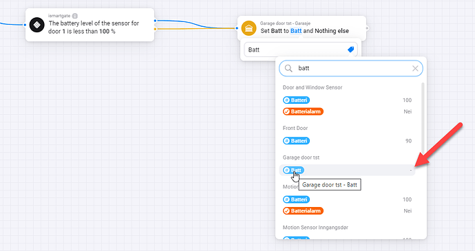

Yes. “Batt” is a number capability I created in the AVD, and I use the [battery] tag of the actual device, to write it’s value to the AVD “Batt” field.

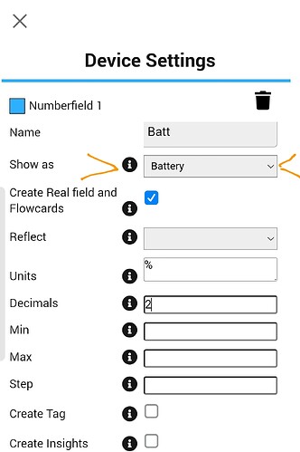

Make sure to use “Show as: Battery”
I have set to Show as Battery in Device settings as you pictured, but I can see when I select the tag Batt, the value is blank. So it seems it’s not receiving the battery value from the smartgate app?
That’s the AVD batt value (which is not set yet, so no value) → you’ll need to select the battery tag from the ‘ismartgate’ device :wink:
