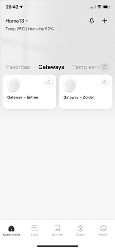

I’ve got two of them, almost all my aqara sensors are connected to the gateway and in Homey with the Mi Homey and Xiaomi mi home app.
Xiaomi gateway v2 (DGNWG02LM), Chinese version

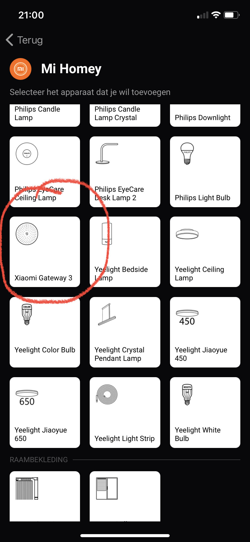

The Xiaomi Gateway 3 also seems to work, but didn’t test it myself:

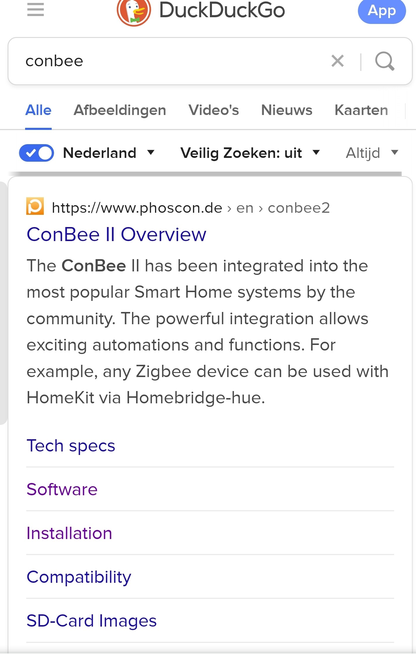

I am able to Google thank you but it doesn’t help explain how it integrates into Homey (in fact the homey link on their page is dead…)
You don’t add the gateways the way you add the sensors. You add them threw More-Apps-Mi Homey (or in my case also Xiaomi Mi Home) and fill in the token. Only Gateway v2 (Chinese) works.
I thought you asked this
The 1st search result, the phoscon site explains it all. That’s why I got the impression you can’t or didn’t search :roll_eyes::roll_eyes:
