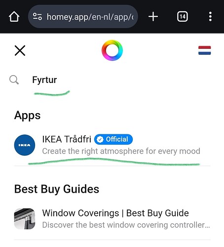

In general, on this Homey forum, when we talk about an app, we talk about a Homey app.
If not, it’s a good idea we refer to it as phone app, TV app, watch app (no pun intended), car app, bike app or such.
And, when I write an app name, in general you can just copy paste it in the app store search bar, and then you’d seen it right away:
Screenshot from 2024-08-18 23-41-36
