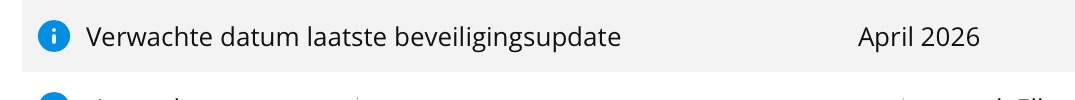

Whether the rumor is true or not is not the point what i posted about, but I read for instance at coolblue site that the Expected last security update April 2026. The other website i cant remember, just that coolblue kind of confiremed the other info.
And i am not yelling, I’m just wondering if others with an early 2018 or even the 2023 version have simular experiences. And I hope someone has a constructive comment about a solution.
If you mean this:
Then look a bit further for what Athom itself says about this: support until January 1st 2028:
https://support.homey.app/hc/en-us/articles/13455016712604-Software-support-for-Homey-Pro-Early-2023
Furthermore, Athom has a very good track record in supporting their Homey’s. Even the very first Homey 2016 is still being supported and gets regular updates.:
So, rumouring about a new Homey in 2026 based on info from 3rd party sites that is clearly contradicted by the manufacturer itself, easily found on their own site, does seem a bit like… :slight_smile:

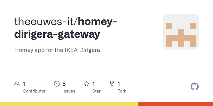

I suppose you searched the Community here for likewise problems/solutions, so you could perhaps ask the developer of the app.
Based on the App page info, he likes you to do that via Github:
