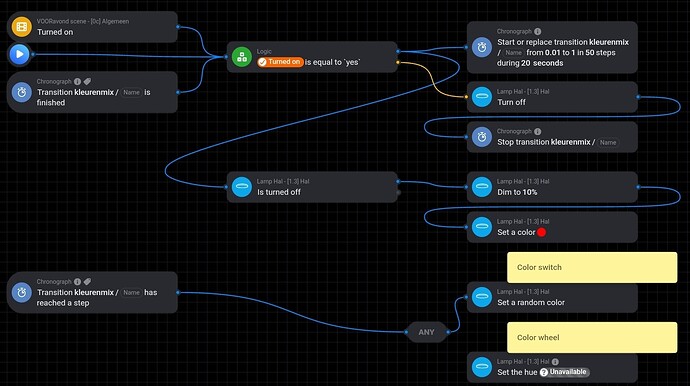

You could use a ‘transition’, to change the color or hue level.
There’s several apps with this functionality, I prefer the Chronograph app.

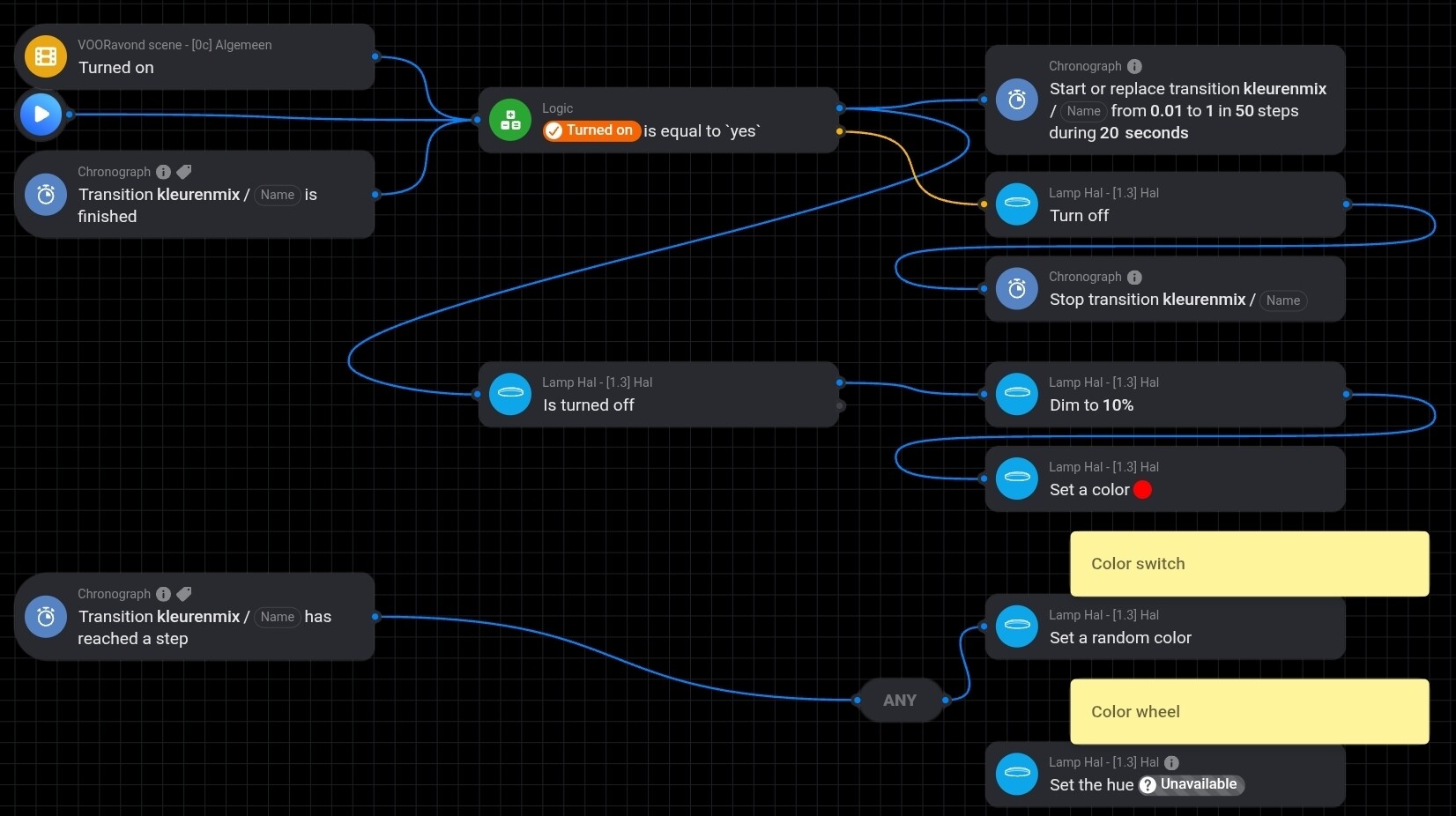

Tested Example:

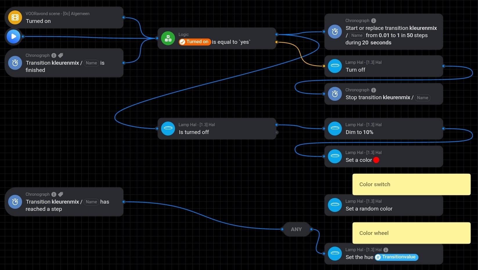

And one as color wheel, which uses the actual transition value:
Flow export (to import: copy and paste all text below into an empty text file, and change the extension to .homeyadvflow.json , like: myimportedflow.homeyadvflow.json -
Next: right click on flow folder and press ALT):
