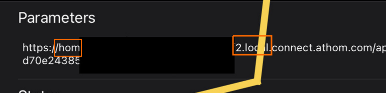

Hello Gregory,
You’re welcome.
Almost there :wink:
I noticed you being naughty and don’t use the correct homey cloud id :blush: :wink:. It does not start with hom and it does not end with 2.local for sure:
No clue how it could have worked nonetheless :face_with_peeking_eye:
But the error msg says
meaning, it has no idea what to do with it.

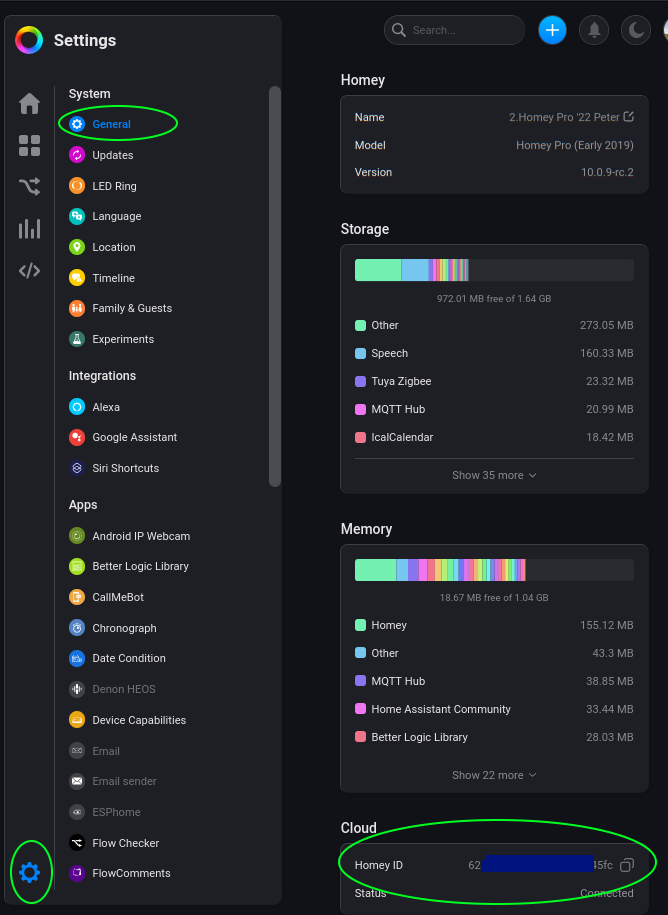

What you should enter as homey cloud id, is a long number:
which you can find in the web app url, it looks like this:
You can also find homey cloud id in System / General:

There were 2 problĂšms :
-1- the one your expert eye saw : as it was for the input in the HOST Line of the CONNECTION dialog box (android »how to above ») i mismatched HOST ID for CLOUD ID.
FYI : for me it is not a « big number » but a 24-digit alphanum ID.
Problem solved

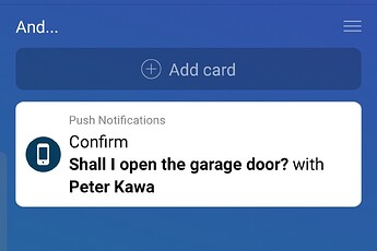

Yeah, you can consider temporary sending notifications first, instead of the actual door opening/closing, until it works as expected.
Or, you can temporary add this confirmation card below to the flows involved; the flow gets paused, until you confirm the push message question within 30 minutes:

→ you are right and that’s what i did, i mean temporarily disable all L&P related flows and test them one after the other
 I had already added for each one of them a push notification card in order to make sure the flow had triggered
 but imagine the mess that happened in the middle of the night the first time OT/L&P connected and initiated 8 flows
 :rofl:
→ good idea, the confirmation card, i will definitely try it, thanks Peet ! :+1:

But, the problem is to distinguish the cars from eachother;
it’s imho not possible to use geofencing to determine which garage should be opened. I assume they’re next to eachother?
When each driver always carries a phone with f.e. Bluetooth enabled, you can consider sticking a Shelly somewhere near the doors, which can determine if your phone is nearby.
I think it’s better to hide a Ble beacon somewhere under the hood, which can be detected by the Shelly
(please ask f.e. uncle Uwe @Undertaker for Shelly details, he knows his stuff).
BUT, it also needs a wifi connection to connect with Homey.
If somehow you could arrange for a network cable to near the garage, you could add a wifi access point there, an old wifi-router would do f.e.
Let me know what you think is possible.
I still like the licence plate trick hehe, but it’s not fool proof I now realize.
