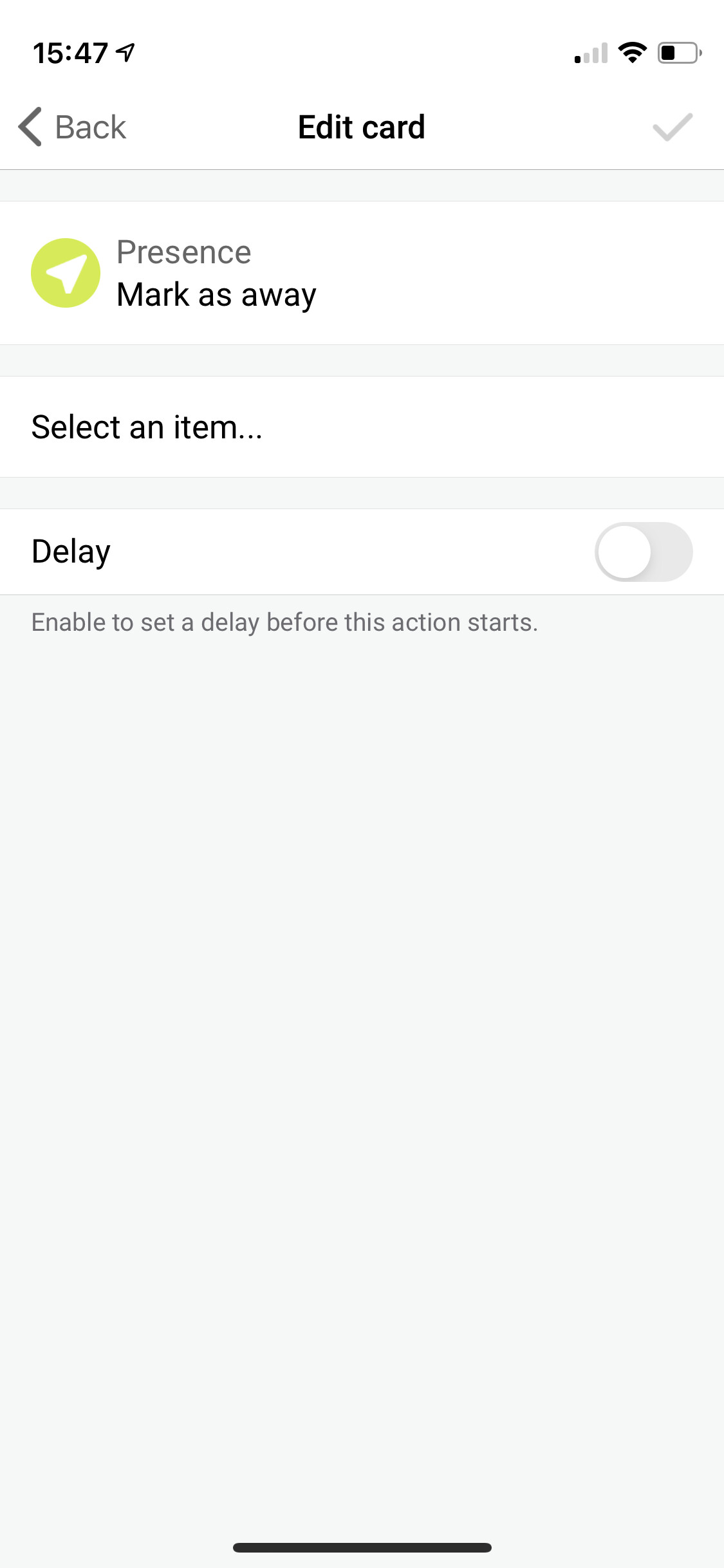

@Hannes85 If I use this card how can set Flow e.g if my wife leave home set mark wife away
 or my son leave set same mark son away
if I use this card of course set mark home/away and send all user notification.

In the “when” column;
In the “then” column you use the “presence” cards and select the name of the right person;
ah I see I need create separete cards all users, here is not working 1 card like factory homey presence.

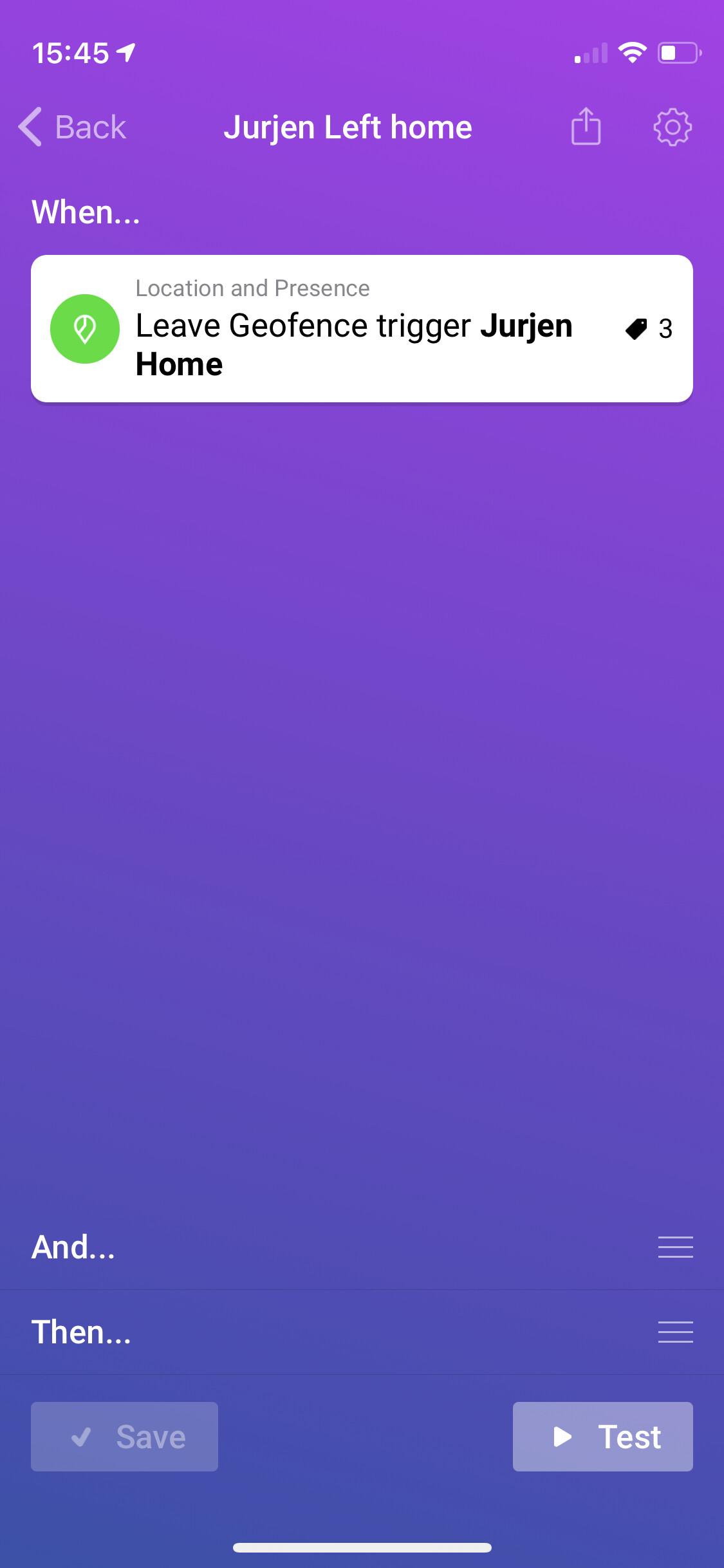

  3. If I make a flow with in the when section enter geofence trigger with the user name and the fence name and then in the Then section a push notification that the user is at home the flow seems to work. But when I make a second flow with in the when section geofence leave trigger this flow works also and that should be impossible because the user is at home.
Can someone explain this to me???

When testing both flows (enter geofence trigger) and (leaving geofence trigger) for the same person, both flows send me a push notification.
The second flow (leaving geofence trigger) should not do that because the user is at home.
The app should see that I think
On point 2 I have set the radius and fence name on both phones manually.
Then it’s normal that you see only one “home” radius. What is not normal is that you do not see the radius. The radius you set in the owntracks app. Once done in all phones (set it with the exact same settings) you can push them by going into settings and then “publish waypoints” and “publish settings”
Can you share the exact flow please?
