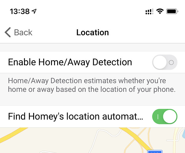

Which homey location desactivate? there have 2 option enable Home/away detection or Find homey’s location automatic? And if I desactivate, this may have an effect on e.g Sun Events app
The home/away detection of each devices in homey settings.
The Location and Presence app will do the job instead.
ok I will try. one more think Location and presence app settings need enable this 3 option?
And if I use Location and presence app and off home/away detection , Can I use the homey factory presence card, or just Location and presence app card use it. becouse than I will rewrite all flow are uses factory presence…
As i said, you keep the homey presence cards.
You just change the way you are locate.
ok I change here my settings and I now arrived my home but the app not work…

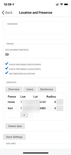

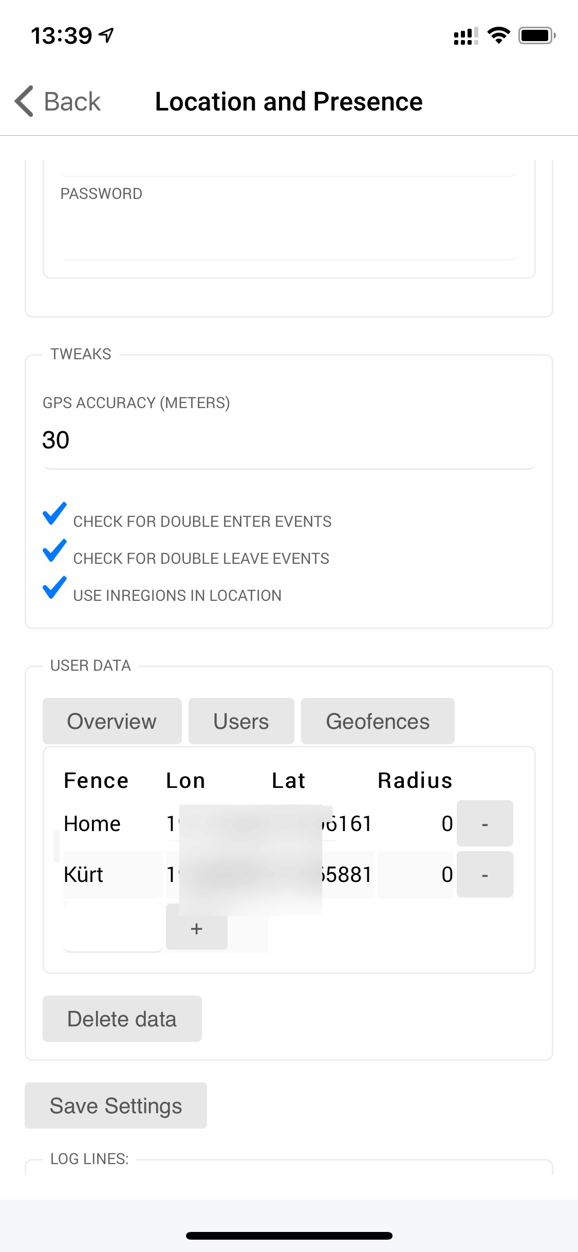

I create flow but app no see fances. Here app pictures
The geofance In own tracks all iPhone same name Home because the my home is 1 location.
Here is 1 my flow e.g
https://homey.app/f/lgPq7B
@Felho
You have to create additional flows for everyone, to let geofence trigger set the @ home or away status, as explained here:
I think you’ll need different home location names for all users. F.i. HomeA, HomeB, HomeC etc.
Otherwise you can’t determine WHO arrived or left.
IF “Location & Presence” geotrigger ‘HomeA’ has been received
THEN mark user A as AtHome
IF “Location & Presence” geotrigger ‘HomeA’ has left
THEN mark user A as Away
