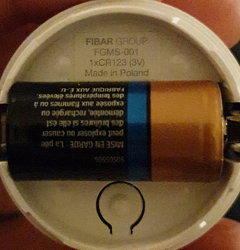

What version is the sensor? FGMS-001 (z-wave) or the FGMS-001-Plus (Z-wave plus)?
Not sure. It shows only on the Z-wave logo. And that is underneath the battery…
But looking at the text i expect it to be an older one.
You can have a look at the developer page at the “devices” section to see what driver it uses.
Either “Driver homey:app:com.fibaro — FGMS-001”
or “Driver homey:app:com.fibaro — FGMS-001-PLUS”
At least, that’s what it says on my 2.0.4 firmware.
