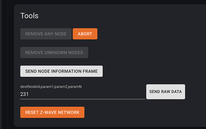

I have a ton of "unknown node"s after migrating ot HP23. I think this is preventing me from reincluding them. I also have the situation where “remove” is greyed out. I also have a the button “remove any node” but it is also greyed out. I could reset the z-wave network or rinstalling the entire homey, but that will take me a day! Anyone has any suggestions
After pressing the 3 dots, and if the choice “remove” is grayed out, then push “test” sometimes you need this to press several times, but then, when no answer is returned, the “remove” will be un-grayed.
I do press a couple of times, and remove is ungreyed, but when I press it I get the message that is is not found, At one point I get the notice that homey is nor primary controller. It may very well be connected to my old defect homey that I migrated from. Im getting kind of desperate with this problem. :frowning:
Guys… I’m getting annoyed. I have four Unknown nodes, all response for test very quickly… while no any option to remove… Even “Remove Any node” button does not allow me to remove these…
