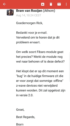

This is a very old still active bug. Should be fixed in 2.x

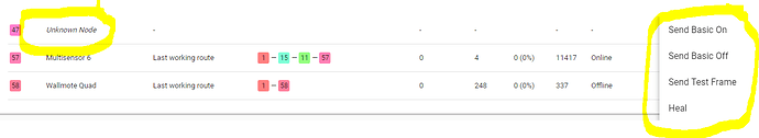

there are no dead nodes in the devices list of the app… i only can see the dead nodes in the developer.athom site
and there i cant delete them… like @PetervdK shown

Okey story continues
Seems like their is a difference between dead and unknown node.
Yesterday I tested in the app with dead nodes removing and this is working like a charm.
Today in logged in the backend via developers.athom.com and see a lot of unknown devices. Those can’t be removed , there is no remove button behind the dotted lines only heal and send on or off state.
Just my 2 cents
Marco
Same here.
