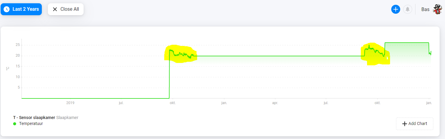

After checking (and yes i neglected to change the battery), a battery lasts ~6 weeks.
this graph shows the same on my other xiaomi humidity sensors.
as this is strange and frustrating i am happy that there is a solution.
