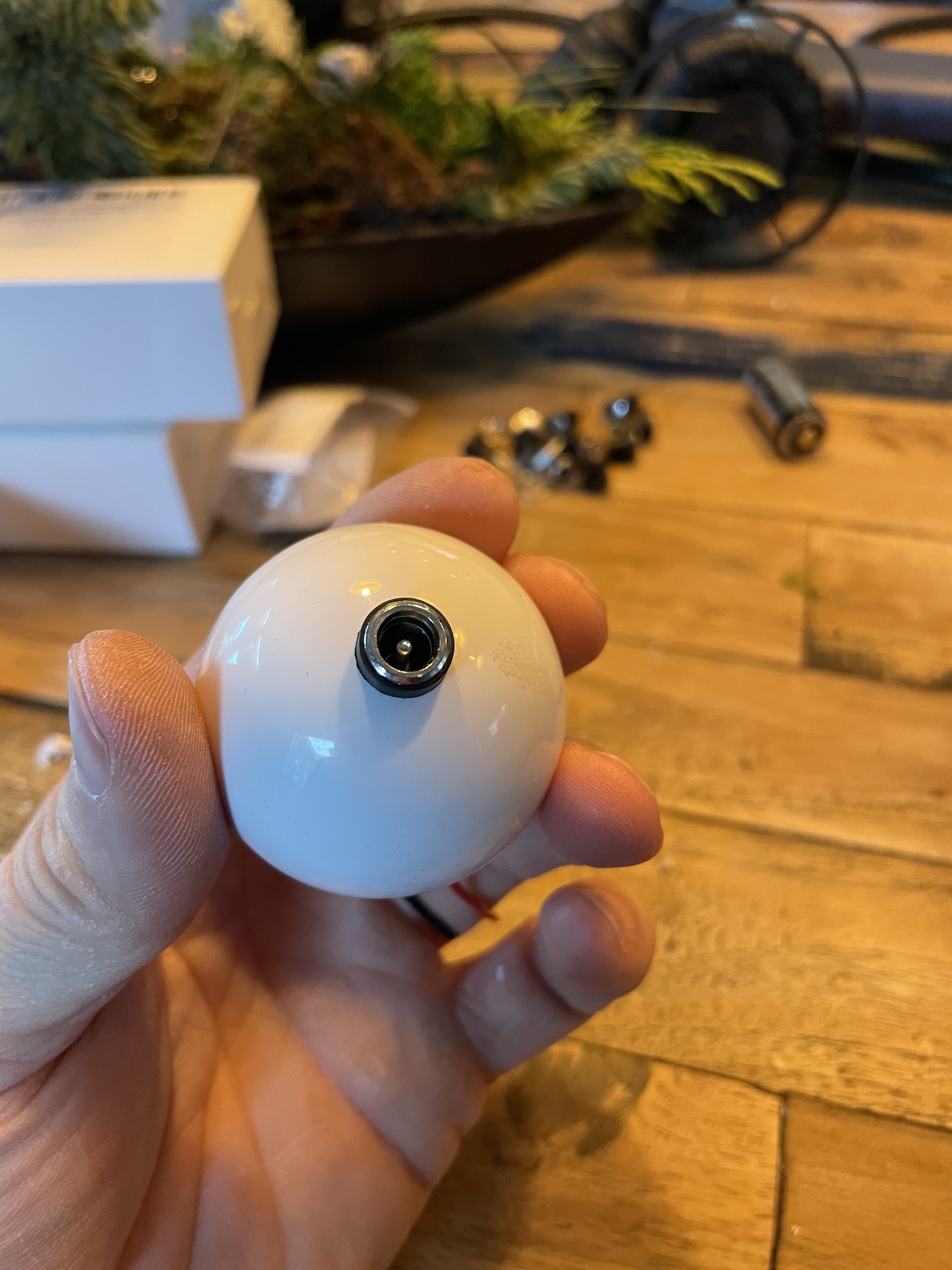

I’ve made my sensor adapter powered, and below I’ll show you how I did it.
Of course, everyone can approach this in their own way, but this is how I did it.
These parts I used:
AC adapter DC 3V 1amp with 5.5 x 2.1 plug
Male 5.5x2.1 DC power plug
Both components were purchased on the World Wide Web.
No more expensive CR123a batteries for me to replace!
