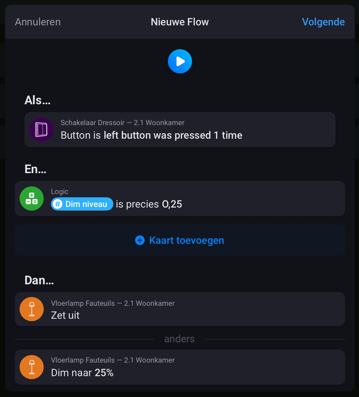

Something like this using an Advanced Flow:
It’s in Dutch, but I hope you get the idea: When you press the button, check the current dim level. If it is at 25%, then switch off the lamp. If not, then dim lamp to 25%.

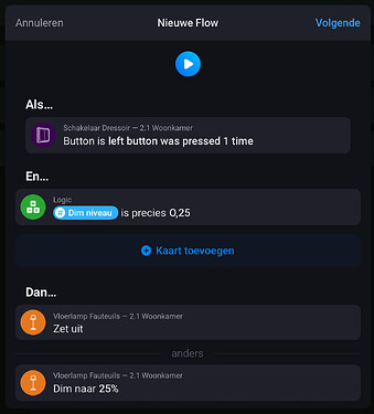

Or in a Standard Flow:
