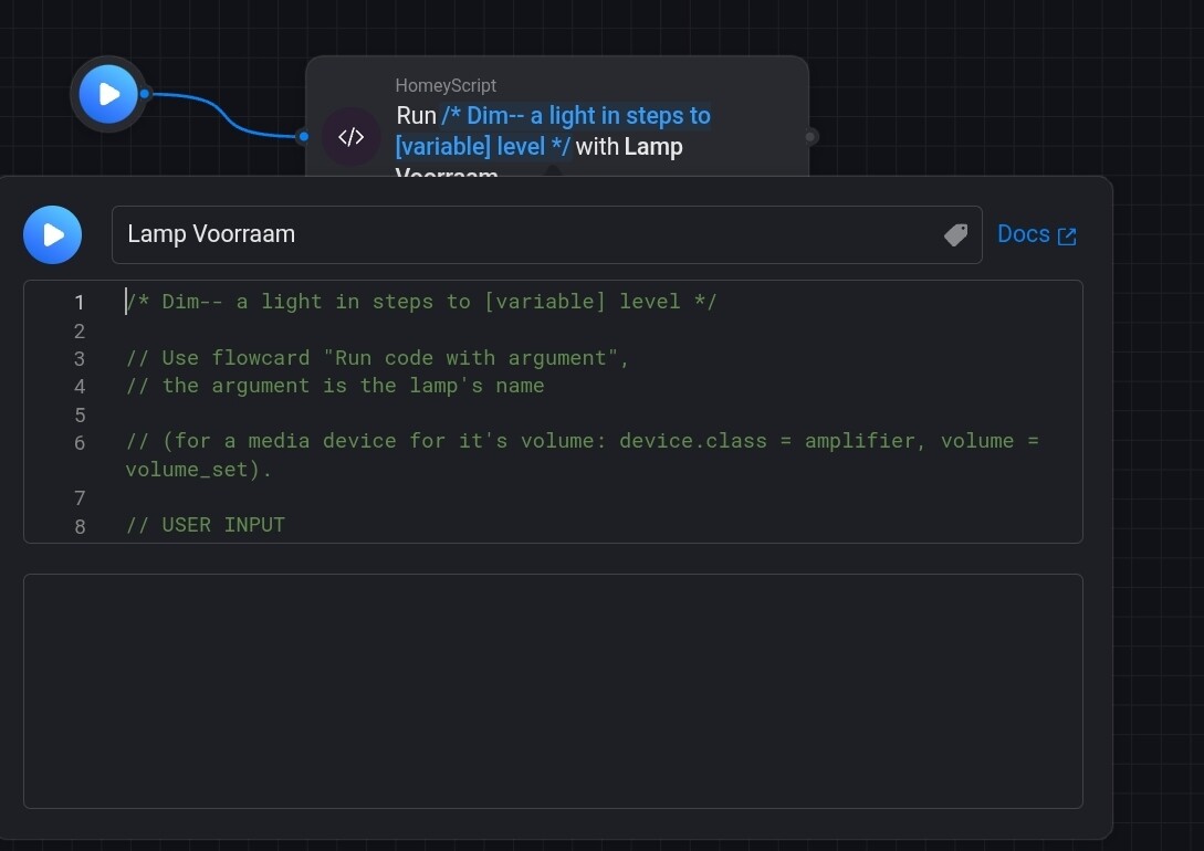

When you don’t mind using scripts, you can use this one below;
It dims a light from it’s current level to the level you saved in a variable. It automatically dims up or down to that value;
You can use flow card “Run code with argument”
Just copy/paste this script, and enter the variable name which holds the desired dim value (0.01 - 1)
Enter the lamp name as argument in the flow card

Here you see the lamp name as argument in the flow card

Thank you @Peter_Kawa ! Not knowing anything really about Script programming… I did some tinkering and figured everything out! Great education for me!
YW!
I’m no programmer either, I built this script a while ago with all info I could find. And no cheatGpt of course :zany_face:
