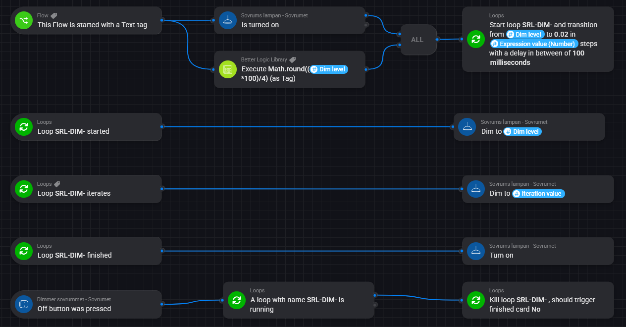

After some experimenting I finaly got it working by pressing button to start dimming and when I press it again it stops at present dim level. I also added a logic to always dim by steps of 5% regardles of where the dim level is when starting.

Then to the acctual dimmin process. There are two identical flows, one for dimming up and one for dimming down (well not exactely identical but you get it) it check if light is on and if there is a dimming loop already runing (this to be able to use the same button to stop the dimming loop) and for dimming up it checks if the dim level is less than 1 (=100%) and if all true it start a second flow for the actual dimming process. Same for dimming down but there I check if dim level is more than 0,01 (=1%).

… okay, so there is one flow for dimming up and one for dimming down, again that are the same but with oposit function so I’m just showing the one for dimming up.
It checks that light is on and then setts the logic for getting a 5% increase. [1 – present dimming level x 100 /5] will give the number of steps needed to get to 100%. (for diming down the calculation is just [present dimming level x100/5]) Then we have the steps for starting, running (iterates) and finishing the loop.
The last step is the function to stop the loop when you are at your disired dimming level. When you press the buttong again it check to see if the loop is runing and if so stops it.

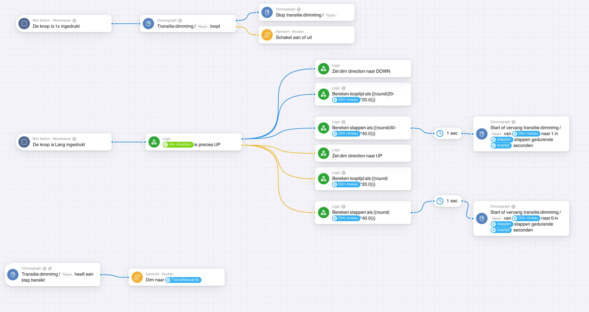

When I saw your flow and counted 50 flowcards I was challenged if I could reduce the number of cards and have simular functions using the Chronograph-app
One click turns the light on/off or stops dimming
A long press initiates dimming in the opposite direction from last time

Great, i just am not experienced enough, could you please help me to get this up running. The thing i do not understand is the variables used in the Logic cards. - help :slight_smile:
You’re right. That part needs a little bit more clarification.
If the dimlevel is 0% and I want to dim to 100% the transition is going from 0 to 1 in 40 steps in 20 seconds. So the transition value becomes 0.025 higher at each step. And there is half a second between 2 steps.
But when the dimlevel is 35% I need less time and less steps to reach 100%
I need 65% (100%-35%) of the time and 65% of the number of steps.
So dimming up: runtime: (1-dimlevel) × 20 seconds and steps: (1-dimlevel) × 40steps
Dimming down: runtime: dimlevel × 20 seconds and steps: dimlevel × 40 steps.

Please share the variables you use/have set …
Thanks, but I only see the names of the variables, not their starting value?
Let’s say the current dimlevel is 0%. A long press will start a transition from 0 to 1 in 40 steps during 20 *)seconds.
So the transition value becomes 0.025 (= 2,5%) higher at each step. And there is half a second between 2 steps.
I need 65% (100%-35%) of the time (= 13 seconds )and 65% of the number of steps (= 26 steps) to dim the light a the same pace.
So dimming up in general:
runtime (in dutch looptijd): (1-dimlevel) × 20 seconds
and steps (in dutch stappen): (1-dimlevel) × 40steps.
Dimming down:
Both runtime and step are recalculated depending the dimlevel and dimdirection after a longpress.
*) 20 seconds is maybe to slow.
