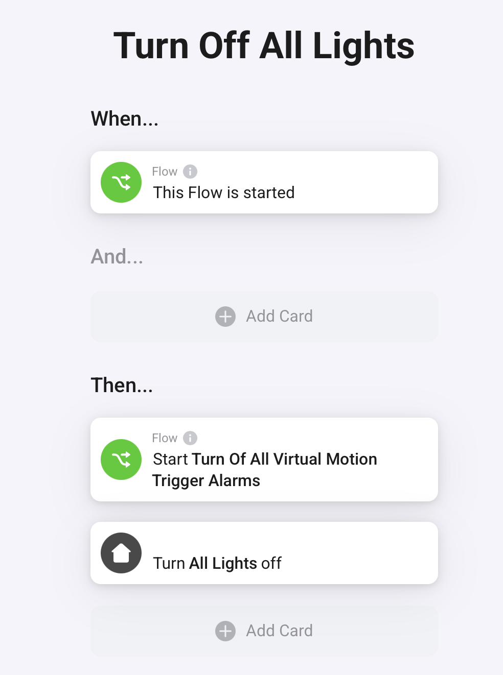

You can also make a simple task to turn of all lights and disable all motion triggers alarms. This is handy when you want to make sure that all rooms are inactive when the last person left the house.
