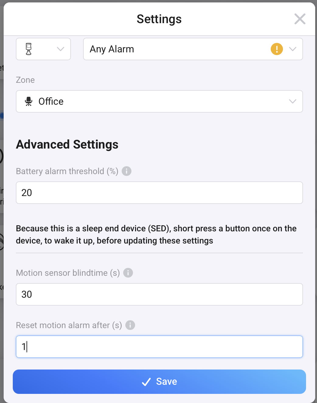

See the screenshots on how I incorporated this into my flows for lighting. You can see that the actual motion sensor only stays active for 1 second. It triggers to flow to trigger the virtual motion alarm for a specific amount of time. Every time motion is detected, it triggers the flow again without deactivating the entire zone. This also solves the problem that the motion alarm is triggered with old luminance values in moest motion sensors. If the Virtual Motion Sensor is turned off, the entire flow turns to manual.
