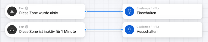

I myself have two rooms in use with “Becomes active” and “Is inactive for x minutes”, and they work fine.
For example this flow:
However, I have NEO Coolcam motion sensors in use with a motion cancellation delay of 30 s. I don’t have an Aqara Motion Sensor in use, so I can’t comment anything about the settings and behavior, but normally his flows should work. So why always these workarounds?

What I already did is, I created this test flow:
I activated the zone and I moved continuously around for about 2 minutes, so that the motion sensor was activated (yellow exclamation mark) all the time. The light didn’t switched off.
After the approximate 2 minutes, I left the zone and observed in the Homey smartphone app when the motion sensor became inactive (after about 30 s). After another 60 seconds, the light turned off.
So everything as it should work.

Hi @Tom_Erik,
today I did your test and the Zone Activation works as it should.
After the last movement it takes approx. 90 seconds for the light to go out (30 s cancellation time + 60 s inactivity). :man_shrugging:t3:
