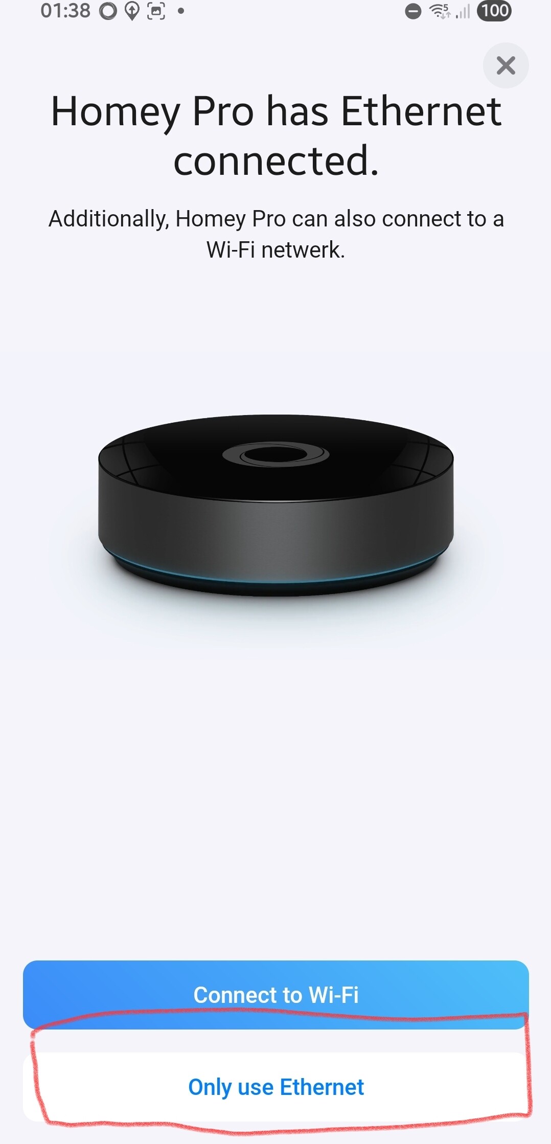

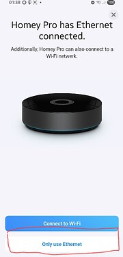

To disable wifi all in all, during setup you just had to pick Ethernet Only, but you pushed the blue button, right?
Or you connected the ethernet dongle later, during or after setup?
See, no wifi:
To disable wifi, just enter setup mode
https://support.homey.app/hc/en-us/articles/7263241090716-Activating-Setup-Mode-for-Homey-Pro
and now just hit the “Ethernet Only” button.

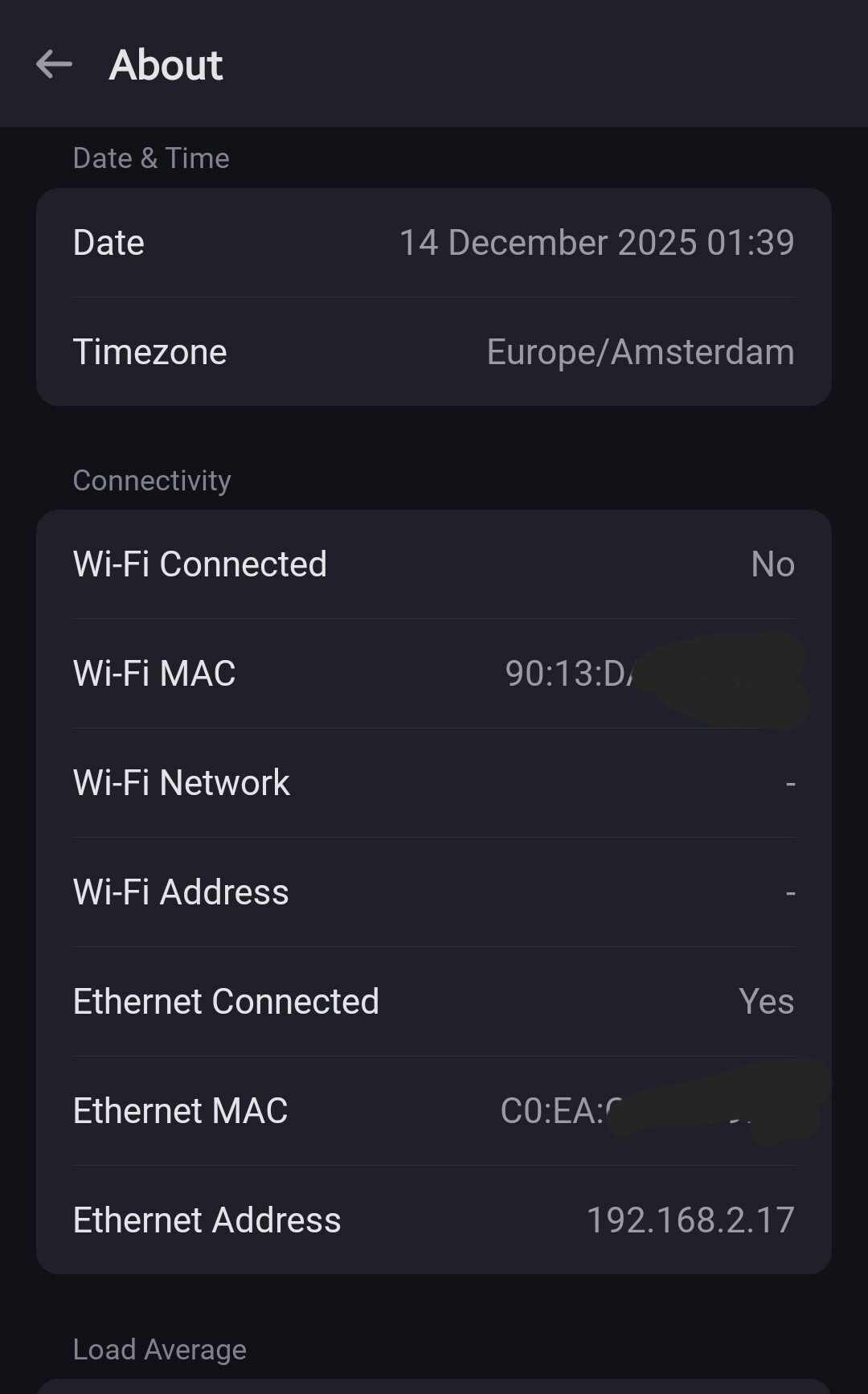

I started last week with my new homey pro 2023. Today I received de ethernet adapter, but somehow Homey is not connecting via wifi.
I see green/orange led on the adapter.according to switch there is a connection.
I have tried the setup mode, but I only see a wifi option.
  • restarted multiple times
  • Tried different network cable
Any suggestions?
In settings of homey it shows
And you connected it the right way?
You’re not the first one not reading the fine manual :wink:
:face_with_peeking_eye: :face_with_open_eyes_and_hand_over_mouth:
Thx!!
It’s even printed on the dongle :winking_face_with_tongue:
But it’s not that weird you probably assumed the dongle and network cable should be near Homey.
