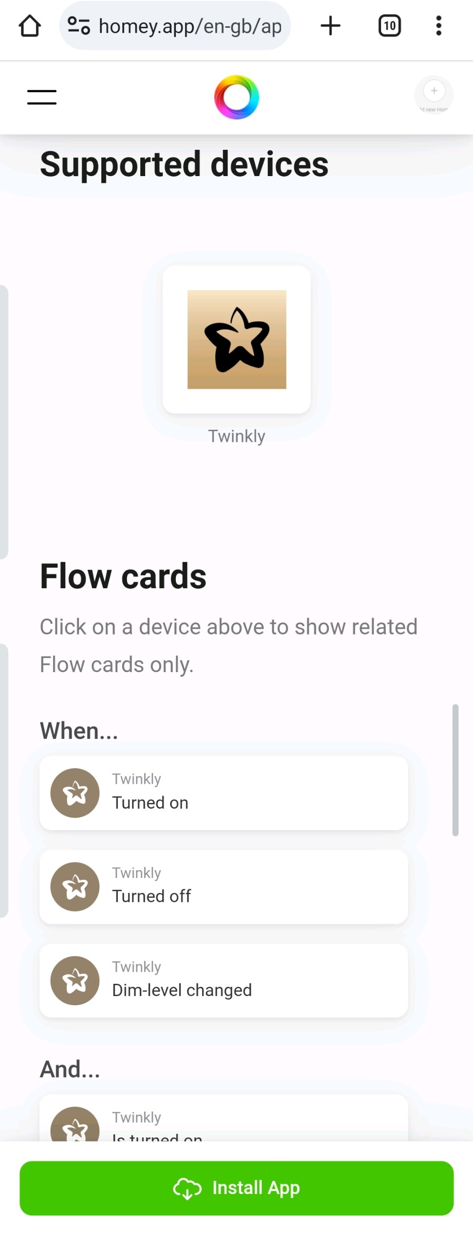

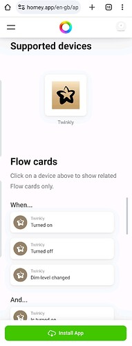

OK thanks. And in this context, could I configure it to control not only Hue lights, but also a Twinkly light strip?
Yes, you can search for brands / models in the app store to see if it is supported. Often the available flowcards are also shown.
