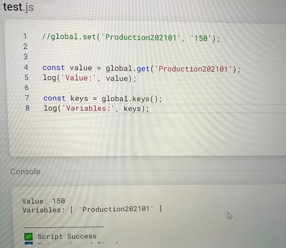

@robertklep Is it also possible to set an array with global.set?
Seems like a really simple thing to test…?
Have tried yesterday several things, but can’t get it working. I will post tonight a screenshot, because somehow it looked like there was array
Perhaps you can only use basic types like number or string.
You could convert the array to string and store it in the variable.
Like I said, it’s trivial to test. And it works as expected:
