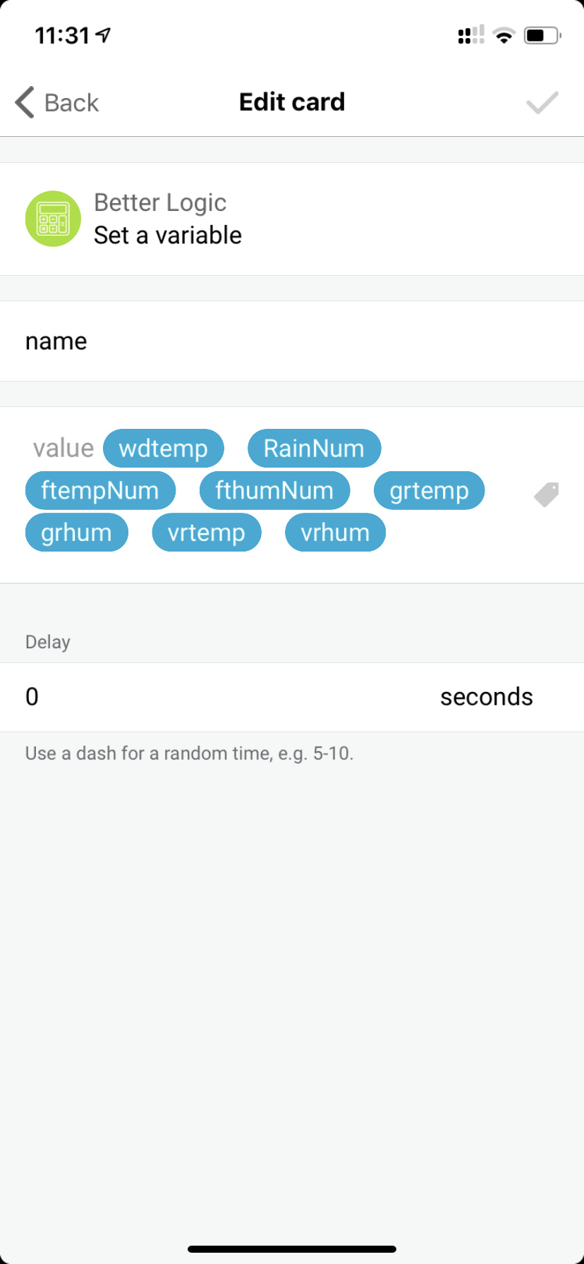

Found the ” Homey has started” but how do I set the variables ? I cant see the variables after reboot under Tags
Use the “Homey as started” trigger to run a (Homey)script that will set the variables.
