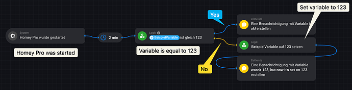

And there is a possibility to check the content of a variable after Homey was restarted:
To be able to get this flow card Homey Pro was started, you have to activate the Power User in the Homey smartphone app: More → Settings → Experiments → Power User

It’s easy to monitor a variable, just create a flow like this:
