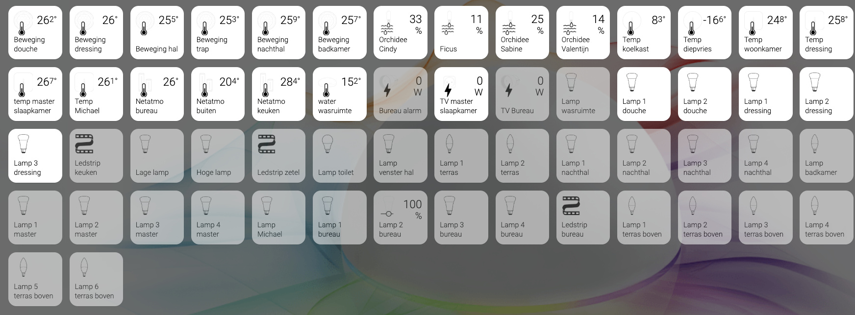

I am pretty sure I am not the only one that woud like to have the Lights diplayed as light and not as some device Icons.
I have made a code for this. Could you please put it in the online Version.
var str = device.name.toLowerCase();
var n = str.search("light");
  if ( device.class === 'light'|| n>0 ) {
	$icon.style.webkitMaskImage = 'url(img/capabilities/bulbOff.svg)';
    $icon.style.backgroundImage = 'url(img/capabilities/bulbOff.svg)';
    $icon.style.backgroundSize = 'contain'
also one svg. proposal:
Thanks and keep the good work.
Maybe I’m missing something but for my lights is this already the case, Ok not all the bulb images are completely correct because its using the normal light image for my GU10’s but I can see light images?
So maybe I don’t understand you but for my Hue’s its working fine I think?
Whit Fibaro, or sonoff devices, you would see a device drawing
The wall plugs I have and configured as lights, don’t show a light icon. They show the wall plug icon.
