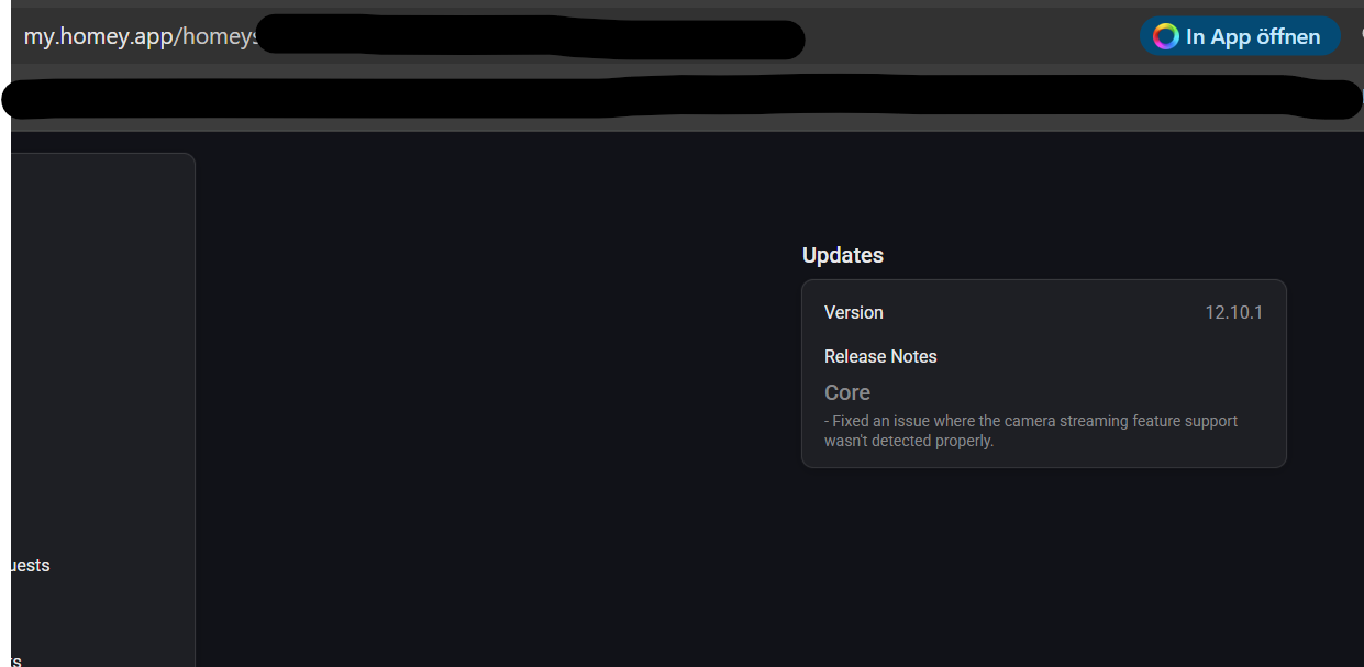

The installation manual mentions it should be done through Container Manager (I normally update my Docker containers by re-pulling the latest image with Portainer or Dockhand).
But Homey has a built-in option (in the app or by local access) too:
Did anyone try this?
Is this safe to use?
And did anyone manage to update by Portainer or Dockhand perhaps?
Funny Henk, we both talked about this topic before ;-):
My experience is that this update option doesen’t work at all with the SHS-Synology constellation.
The Docker project from Athom with the bulid option does the job of downloading the latest version installing the image and buliding the container. But the steps of stopping and deleteing the old configuration manually is a little bit annoying.
