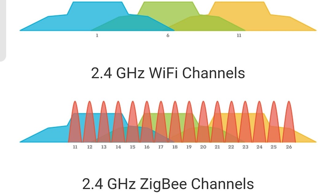

For example: Any Wifi 2.4GHz signals on the wrong channel can interfere

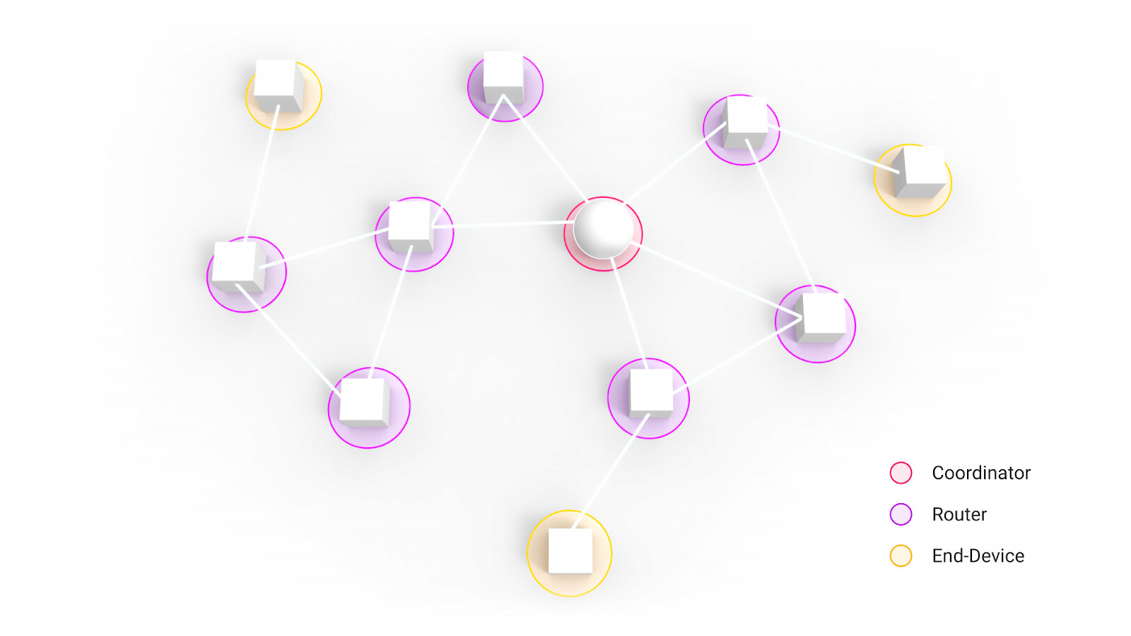

The order they refer to, probably is
  1. add and pair router devices, the first one(s) near Homey, the other ones should be paired at, or near to their final position.
  2. add and pair end devices, keep them at, or near to their final position.
Note: Osram router devices aren’t the most reliable. It’s also model dependent I guess.
Yes, the more the better, to cover all corners of the house. Zigbee has a safe usable indoor range of, say, 3 to 4 meters. So start with a router device A a few meters from Homey, next, router device B a few meters from router A and so on, until the farthest sensor is in reach of a router device.
Hue and Homey are separate zigbee controllers, unaware of eachother’s presence. Their networks sure can interfere however, check if they’re not using the same channel, or ‘neighbour’ channels.
It’s pretty easy to change the Hue zigbee channel, it’s best to turn all Hue devices on, before proceeding.
Be careful with changing Homey zigbee channel (in worst case, you have to re-add some of your devices).
Maybe it’s easier to fix your 2.4GHz wifi channel to preferably channel 1, 6 or 11;
the best choice for the wifi 2.4GHz channel is channel 11 in your case
as you can see, zigbee and wifi channel numbers differ, and are not in the same band.
It’s not exact science, lots of things depend on your specific situation (for example interference of other devices (close neighbours’ wifi!) and the design of your mesh network)

Done, now zigbee is set on channel 20.
For the Wifi I cannot change it, I think, because my WiFi network is an Eero based one (Eero 6 Pro, 6+ and 6) and I can’t find how to setup the channel, but I’ll try to search. Unfortunately the Eeero Mesh system has few configuration capabilities.
