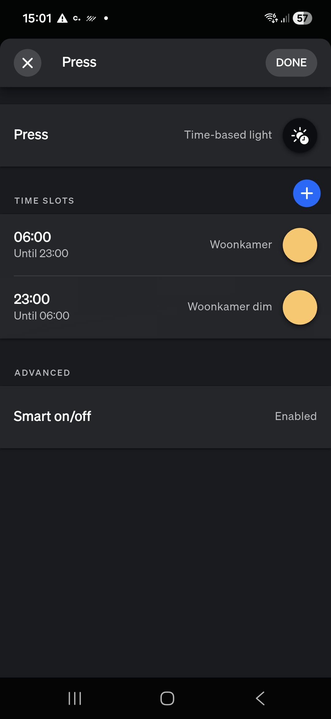

So does that mean you control most scenes and switch events directly on Hue? That’s possible, of course, for simple applications. But I often like to use a different sequence of scenes when switching, depending on the time of day. Unfortunately, that’s where Hue falls short.

You can also use the Dimmer Switch events in Hue.
That’s actually supported by Hue as well nowadays.
Go to Settings→Devices→Switches→[your Dimmer Switch] to open the menu.
I prefer to use the Dimmer Switch buttons in Hue natively, since it’s way easier to set up in the Hue app. It is certainly possible in Homey Advanced Flows (I’ve used that back when I still had Tuya lights in the living room), but it’s not easy to build or maintain. I would recommend using the Dimmer Switches in Hue natively.
