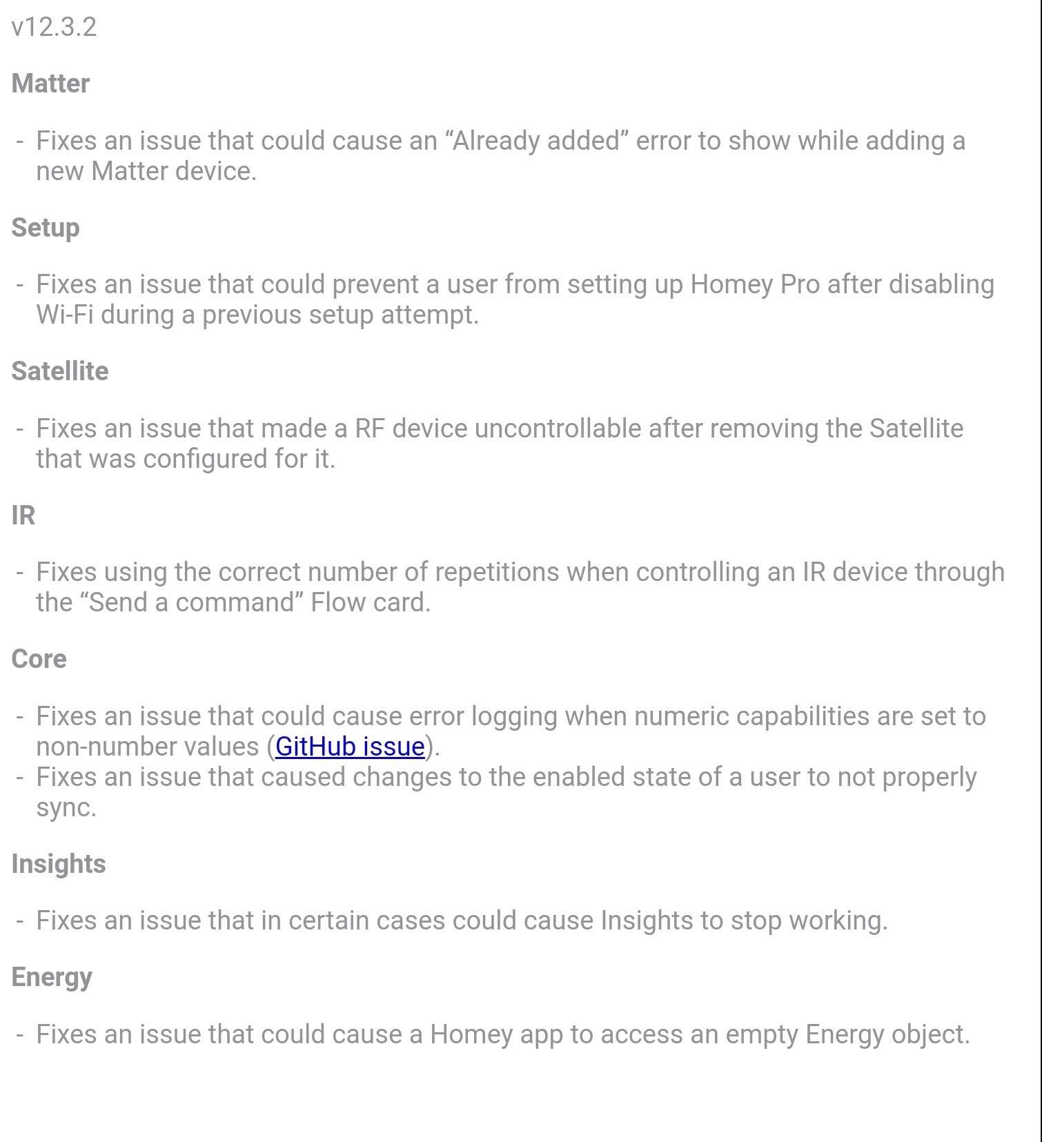

Homey Pro (Early 2023) v12.3.2-rc.2 has been released to the beta channel.
Matter
  • Fixes an issue that could cause an “Already added” error to show while adding a new Matter device.
Insights
  • Fixes an issue that in certain cases could cause Insights to stop working.
Setup
  • Fixes an issue that could prevent a user from setting up Homey Pro after disabling Wi-Fi during a previous setup attempt.
Satellite
  • Fixes an issue that made a RF device uncontrollable after removing the Satellite that was configured for it.
IR
  • Fixes using the correct number of repetitions when controlling an IR device through the “Send a command” Flow card.
Core
  • Fixes an issue that could cause error logging when numeric capabilities are set to non-number values (GitHub issue).
  • Fixes an issue that caused changes to the enabled state of a user to not properly sync.
Release Datum: 10.02.2025

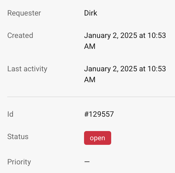

Übrigens, am 02.01.2025 hatte ich ein Support Ticket erstellt, weil mein Philips Hue Outdoor Sensor von jetzt auf gleich das Zigbee Netzwerk verlassen hatte. Das war das allererste Mal seit dem ich einen Homey habe. Das Ticket ist nach wie vor unbearbeitet und offen:
