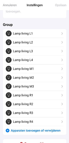

I have 11 new philips hue gu10 white ambiance (400 nits one) in one group and use the native zigbee device “app” when there is no app compatible because Philips hue without a bridge does not support those lamps yet. But it should not make a difference to the problem and is not related I think.

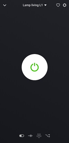

Screenshot in the attatchments.
