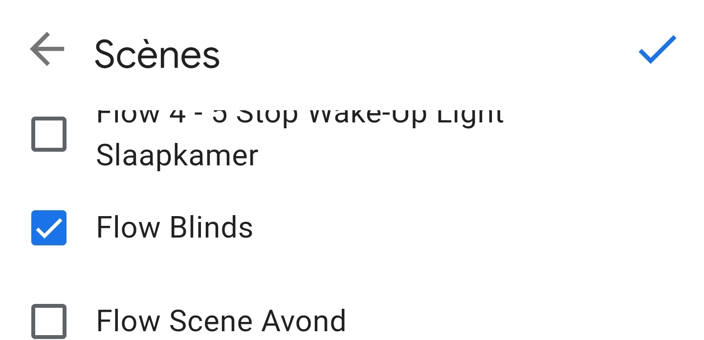

In Ghome, create a routine with starter: voice command “blinds”
As action, select “Adjust scenes”
Select “Flow Blinds”
