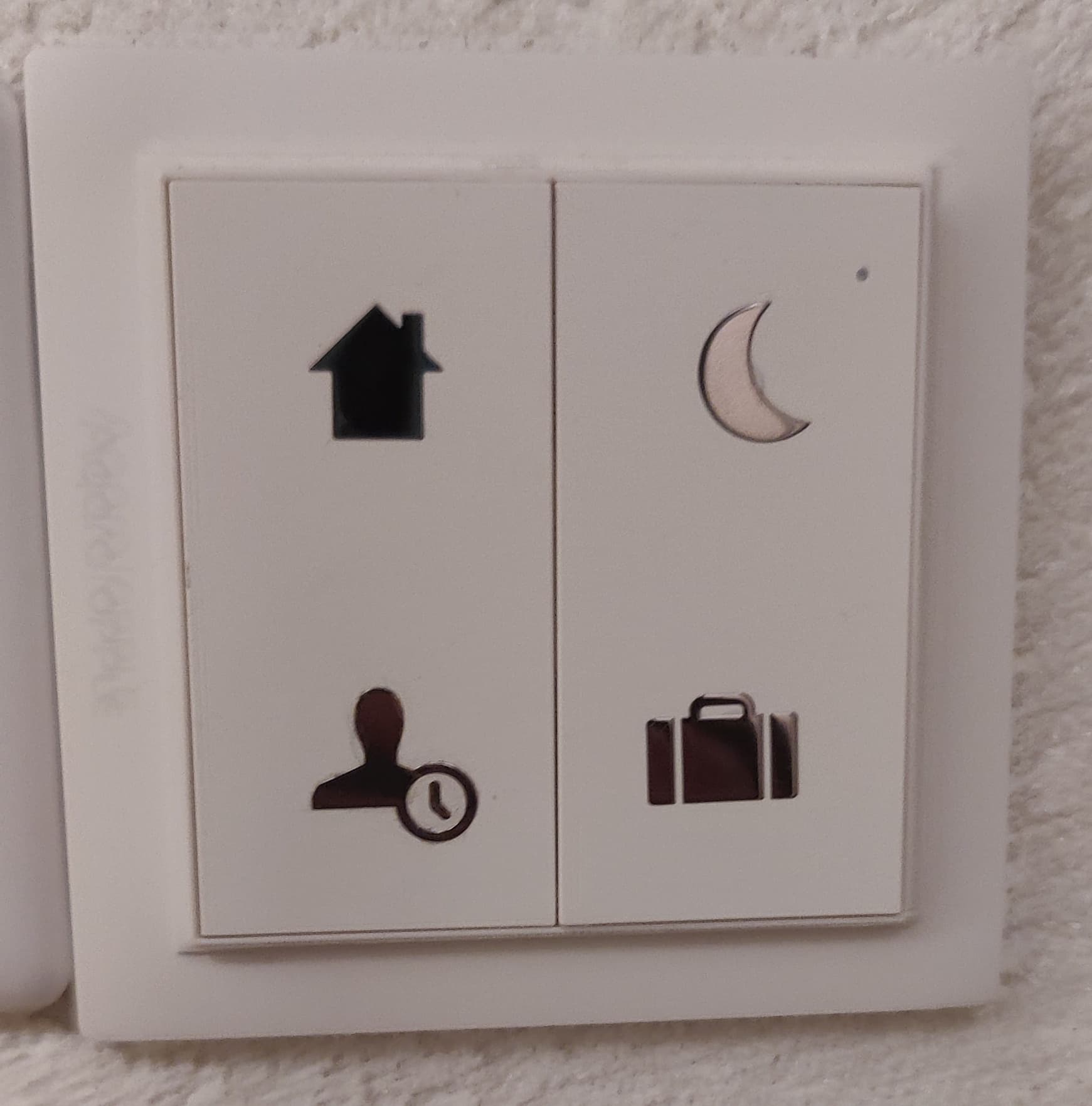

For the elderly I would go for physical buttons as much as possible:
Thanks for this tip. Which button is that in the picture?

Aqara Opple, stickers are added by me.
