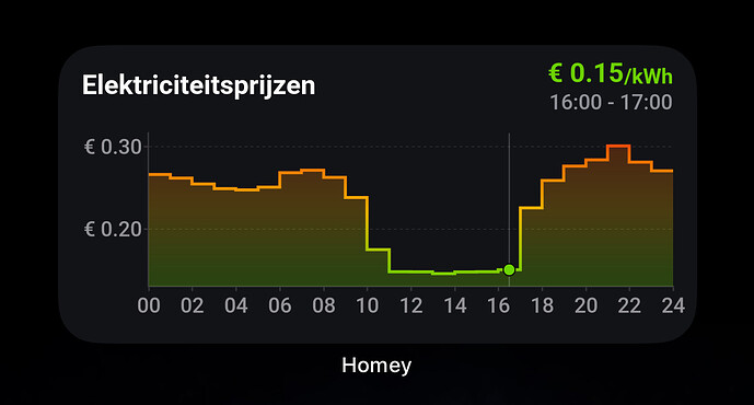

The widget is a nice way to have a quick look at the current price.
I just enabled it, and it looks nice.. something I ran into was that unlike in PbtH the tarif value has to be entered without the BTW(VAT). That caused me to initially see either a wrong value at low-times or a wrong one at peak times when comparing it to my energy provider values (or PbtH)..
So if you already use PbtH and know the tarif value from there, remove the VAT first (in my case I divided by 1.21 as I have 21% tax).
