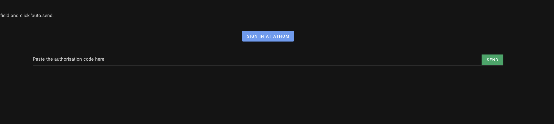

I am having a similar issue it seems.
I am using Homey Pro, I uninstalled google nest SDM as I wanted to try and reconfigure it and now I can’t reinstall it.
I have downloaded the App and it is on my homey
I then go to log in to the Homey Community store and it seems to take me no where
Screen Shot 2022-03-21 at 8.43.28 pm
Uploading: Screen Shot 2022-03-21 at 8.43.37 pm.png…
It just finishes with the blank screen of the Homey Logo and I have not logged in.
If someone could help that would be great.
Thanks
@Mitch_Hare I have experienced the same a while ago. For me using a different browser to get the code worked. You can use that code in the browser of your preference.
Thank you so much! Using another browser worked
