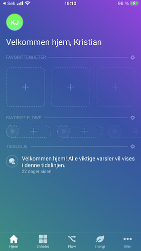

Yes i can log in to the website version. And i see that the home and room where i try to add the homey bridge is established.

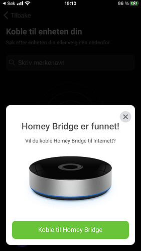

What if you dismiss the ‘found a bridge!’ screen, and try to add the bridge like suggested here (and turn on Bluetooth & enable Location permissions):

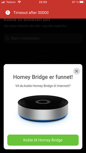

Same thing unfortunately. I see that the pulsing light shifts from blue to green when i click «connect homey bridge» before shifting back to blue before the message «an error occured…»
However, sometimes, when i dismiss the first popup of «homey bridge found» and rather try to add it with plus in top right corner, the light on homey does not change, and i get timeout.
