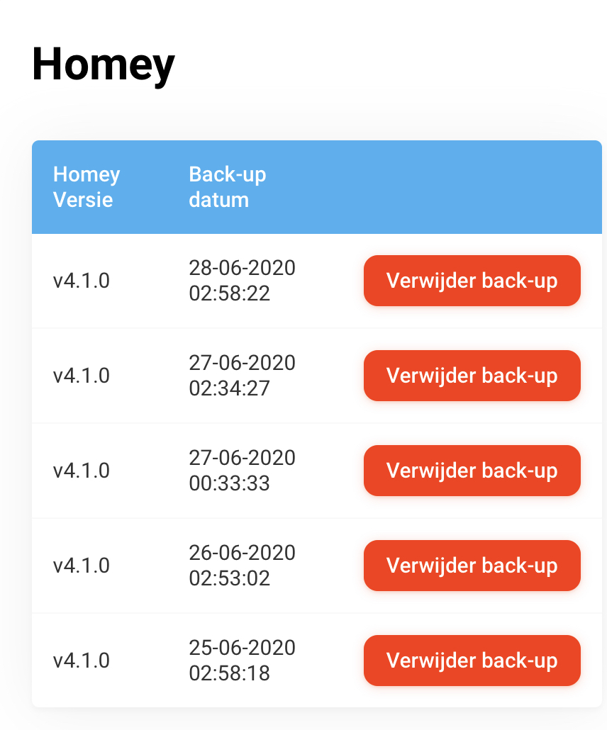

I wanted to put back my backup of 3 days agoo (i was sure the system was stable at the
At time)
It turned out thst backup was no longer available!
The last few days homey had been making multiple backups per day. So my 7 days were reduced to just 3 days backup and multiple options for yesterday.
That sucks! made a report to athom)
i decided to quickly remove several of yesterdays backups to at least make sure I would not loose the older ones.
It forced me to perform a backup sooner then I wanted (did not want to risk loosing my option to backup the 3 day old)
Luckily backup solved my issue (so it does not really suck that much :slight_smile:)
Screenshot just shows one (realised too late to make a screenshot) there where 2 more on 27 june
Seems a bit pointless to make three backups thát close together in time (also as an aside: every developer knows to not schedule automatic stuff between 2 and 3am lest you want to either miss an action ór get a duplicate when daylight savings time changes :joy:)
Didn’T even see that one.. but true
It had 2 more close to that time. (I deleted them before realizing to make a screenshot)
Its reported to athom..
No idea what would triggger these extra backups.
Since we have only 7, these extra backups caused losing 4 days of history backups..

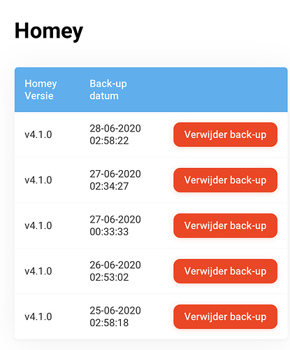

Where are my backups?
If I go to Mijn back-ups | Homey all I see is:
That scares me a bit …
Ask Athom.
You can do that via support@athom.com
It is up again. Athom just wanted to scare me…
