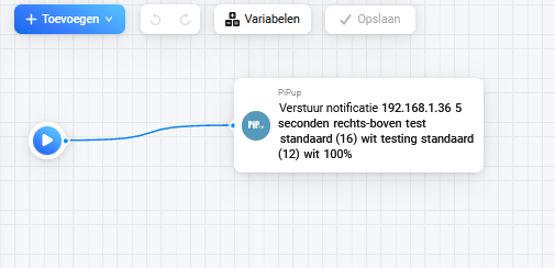

You need to add a start button (right click in the advanced flow choose add start) in the advanced flow and then you ‘start flow name’ as usual in the normal flow
2022-07-28_ 113815
It worked, thank you!!
