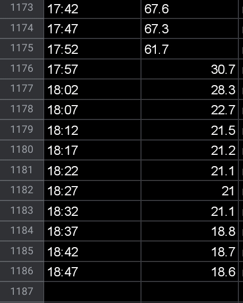

I have been logging the temperature of the water heater to figure out if I can tweak the power saving further.
Look at the log in the picture below:
At 17:52 I take a shower. Probably 6-7 minutes long. The temperature in the tank seemingly drops by about 40°C. Seems like a lot. I have the 300L tank.
Now, around 18:30 my girlfriend also takes a shower. About 10 minutes. When she starts her shower the tank says 21°C. I would expect that to be a cool experience, but no. There is plenty hot water for her entire shower, and still is after she is finished. And after her shower, the temperature only drops by two more degrees.
My question I guess is, how/where does the tank measure the temperature? Because it obviously does not represent the output temperature.
Edit:
Found my answer in the manual (Norwegian):

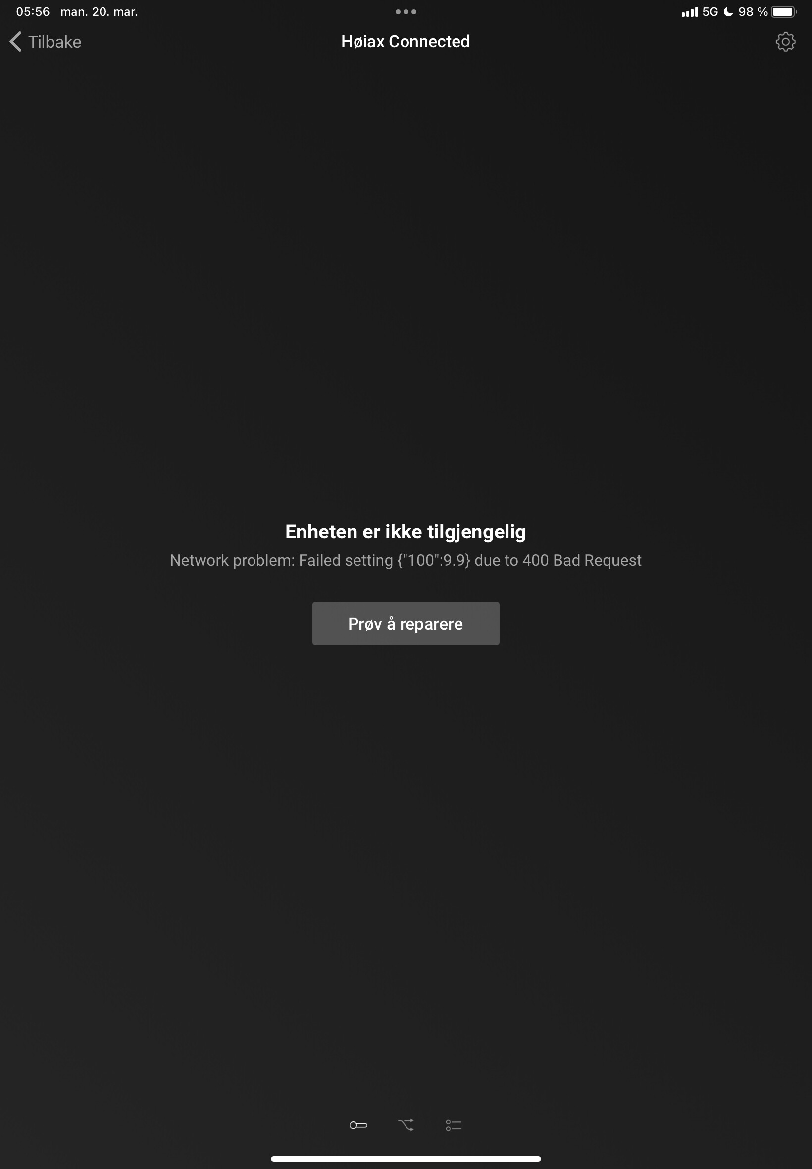

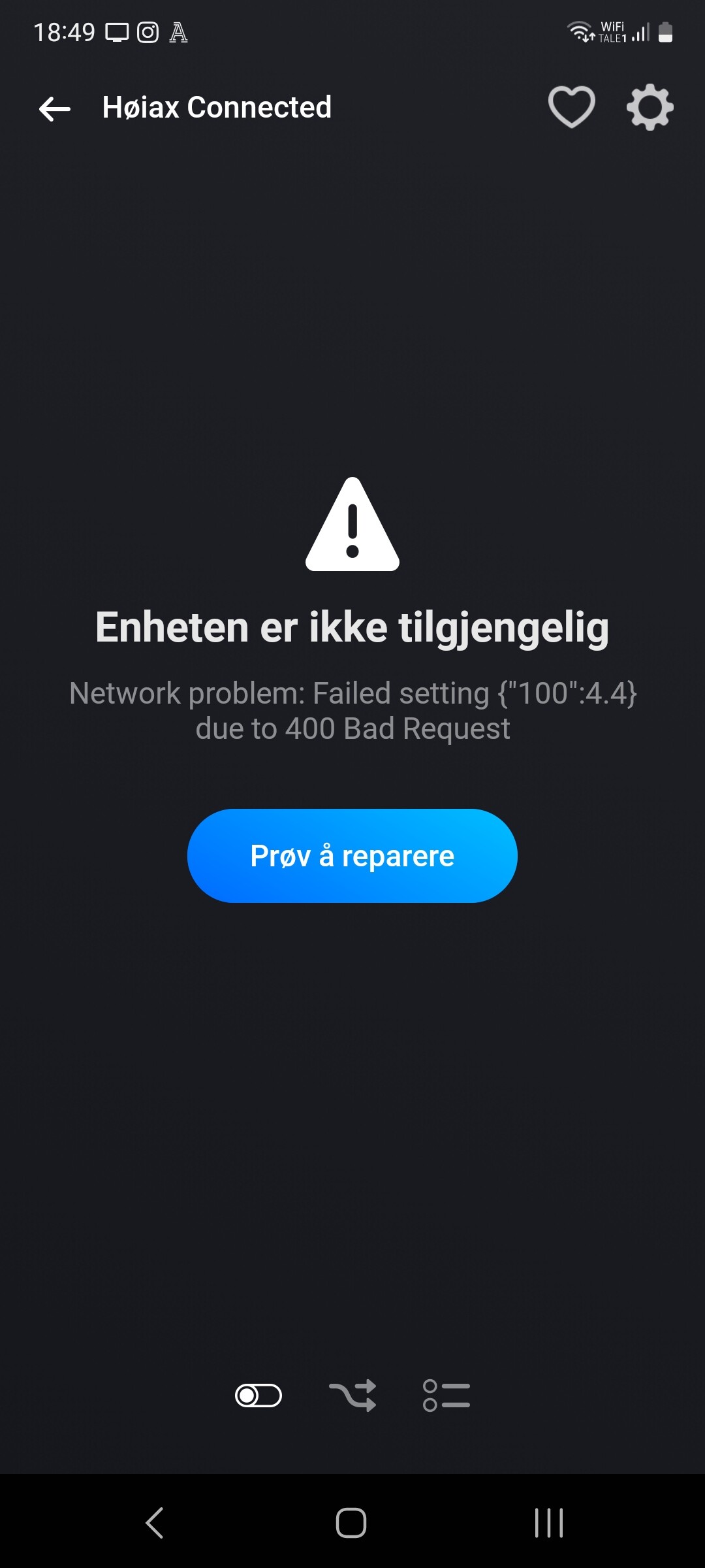

Some issues popping up this week, tried readding but to no avail
Please advise
Br
Vegar
Setting 100 is the average ambient temperature.
According to myUplink this can ONLY be within 10 and 35 degrees.
You are trying to set this to 4.4.
Thus, it is an invalid request.
Is it really this cold where you have the water heater?
If so you should be careful that none of the pipes freeze. (in case of a power outage I don’t think 4.4 degrees heat capacity will last very long)
(yes, I suppose I could add a clamp to the value too so you wouldn’t get an invalid request, but until then you can clamp it yourself (or heat up the room with the water heater) :wink:
Thanks! Yes, it was exactly what I saw as well. The basement is cold, and I have considered covering the heater :slightly_smiling_face:.
Thanks and sorry for raising a false alarm!
V

I often have to restart the app, but now continuously get this error. Only me ?
See above for the reason, @hyldmo reported the same above. I will fix this. For some reason Høiax decided that you never should be below 10 degrees in the room with the tank… You can clamp the value yourself in the meantime.
I created this ticket to follow up: Make sure the room temperature is clamped within the supported range in myUplink. · Issue #7 · frodeheg/no.hoiax · GitHub
New version 1.7.22 out for testing
The only change is that the ambient temperature will be clamped within the range required by myUplink 10-35 degrees Celcius. This will ensure that the app does not crash when the room temperature exceeds these ranges.
