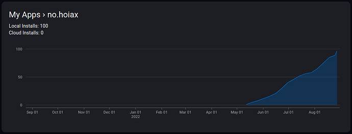

Congratulation to the one that just installed the app, you’re user number 100 :slight_smile:

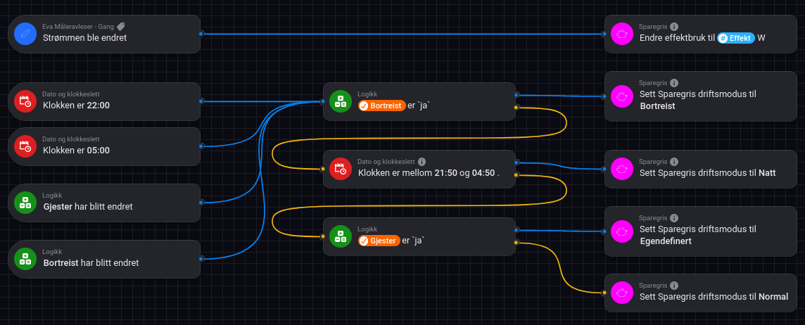

I use the following flows:
and I installed the app Norwegian Electricity Bill App for Homey | Homey to get the current prices. This is automatically transferred and no flows required.
Then in the app Sparegris I set the following states:
Of course, I let the app control all other heating sources in my home too, but you asked for Høiax in particular. The above would control it as follows:
  • 65 degrees normally
  • 85 degrees when the price is low
  • 55 degrees when the price is high
  • off when the price is extremely high
    All within the 5 kWh power tariff, so it might also be turned off for example when I make dinner or other heaters with higher priority are on and we are likely to overshoot the 5 kWh power tariff.
