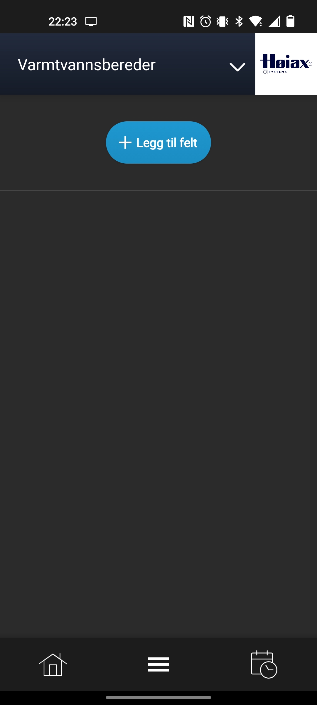

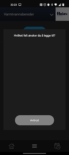

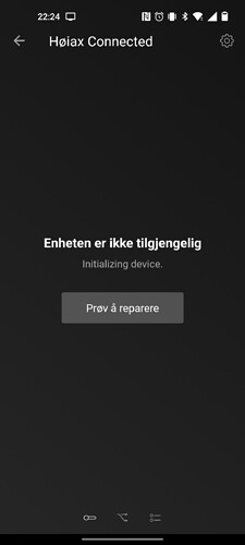

Looks like some problems in prev post, but posting here just in case its useful.
I would guess that is related to the ongoing Høiax problems with myUplink.
@Alf_Jonny_Nokling Does this error resolve by itself or does it stay in this state forever? Also, did it come after you entered the device settings and tried to save, or did it just pop up by itself? If it came after you entered the device settings does it go away if you restart the app?

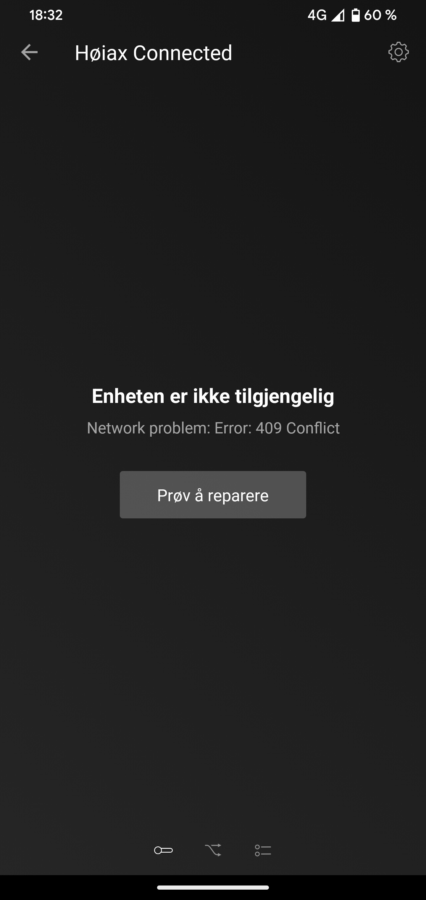

@frodeheg, just happened by itself. Reboot of app/remove device add it again same result. Prob has something to do with ongoing problems.
I see my heater is offline in MyUplinkApp as well.
Its connected to wifi and everything. Thanks for your effort frodeheg, must be annoying for you :slight_smile:

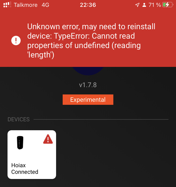

1.7.8 gives me this error…
I tryed to «repair» , uninstall and reinstall
Yes, I know, sorry about that. It’s already fixed in version 1.7.9 :wink:
