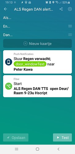

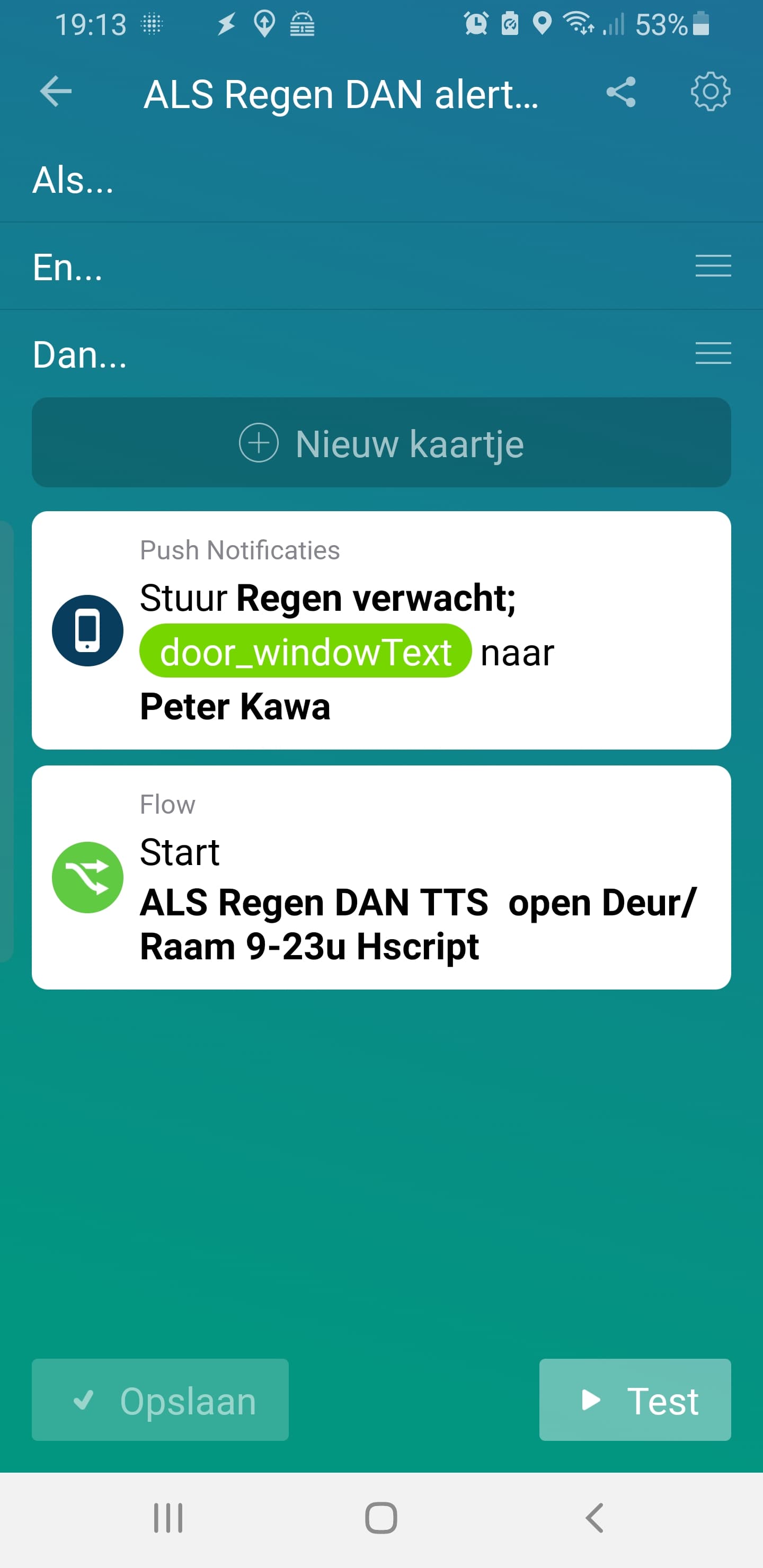

Flow:
You can simply run the script from a AND card (go to Homeyscript in the list, and then select the script), and as action, create a notification card and select the variable [windowText], which is grouped under “Homeyscript”.

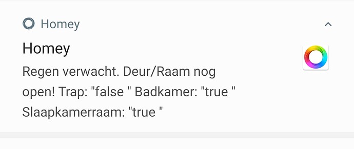

Screenshot of the action card while the “share a flow” doesn’t display the variable:
Result pushmessage (it reports an open door and window):
Thanks a lot! I didn’t know exactly how it worked. Now I’m happy :slight_smile:

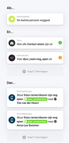

The devices:
Screenshot 2022-06-07 at 08.45.42
Screenshot 2022-06-07 at 08.46.55
The flow:
Did you test the flow? What is the first condition? Is it true in your case that the flow is processed?
And keep in mind: The script is returning a bool result. So your flow will continue to the Then part only if a window is open. If you would like a message if all windows are closed, you need a push messa in the Else part like “all right, alls is closed” :wink:
This is what happens when I run the flow with a window open.
The first AND is asking if not all the contact alarms are off. So that part is saying that there are contact alarms open. Then it stops at the Homeyscript part.
If I run the script with a debug line, it says that all the windows and doors are closed, but this isn’t true. So the script returns false but it should be outputting true.

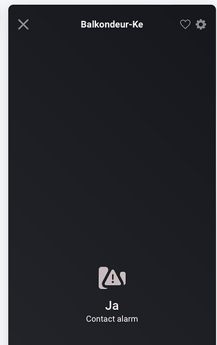

Yes, the open sensor is included in the script.
Its the Balkondeur-Ke sensor.
Screenshot 2022-06-07 at 13.22.29
and alarm is true
