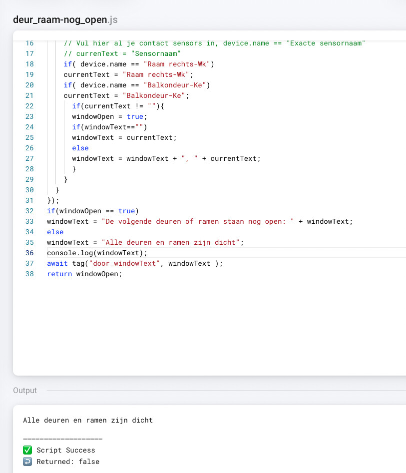

That is the strange part. The device name is exactly the same. I also tried with console.log to display the text but it will always respond with false. Very strange…
Is the script processing the part inside the line above?
Can you print the windowText and check what’s filled in?
Hi RonnyW, you mean like this?
output is none
Just after the IF brackets { }. At the current place the variable is not alreasy set.

still says that the windows are closed
Why not putting many console.log lines in your code, so you can see the different values at many places. ( I did this for device.name, you can use the result for copy-past )
Run this code by the Test command and you see directly if the values are as expected.

This script also doens’t work for me, very strange…

When I close the door, the script also returns false. Invert sensor also doens’t change a thing.
I also tried reinstalling the Homeyscript app but still the same… :frowning:
PS. I also tried changing the name of the sensor but this also gives the same result…
Auch. That is odd.
What happens if you temporary replace the condition “not all contacts are off” with “Balkondeur-ke contact is on”
