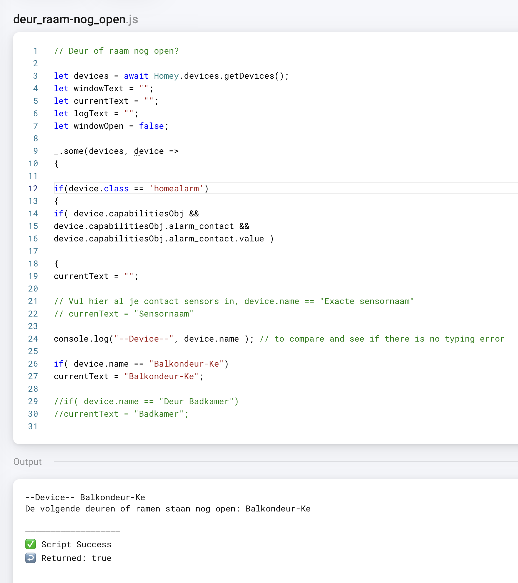

The device type ‘sensor’ could be a problem. Perhaps it has another type, but the alarm_contact capability.
A complete screenshot from the device (developer page) would be nice.
This is mine
Okay, after changing the script from ‘sensor’ to ‘homealarm’ the sensor will show up when running the script :slight_smile:
Now… How can I make the script look at class ‘sensor’ and class ‘homealarm’?
EDIT: I think like this?
if(device.class == 'homealarm' || 'sensor')
think it would be like
if (device.class == 'homealarm' || device.class == 'sensor')
Looks like both work.

Oh that ringed a bell!
It’s indeed a wrong device type in the app:
